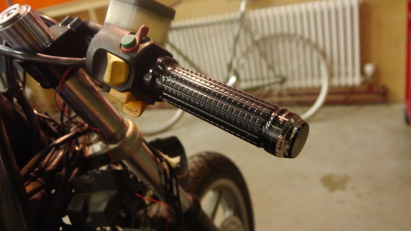

 - I was able to install one side of the grips and handlebar indicators and temporarily have it wired up. However I forgot a rubber grommet for the inside of the grip so will need to install that next time and neaten all wires.
BMW K100LT ABS Cafe Racer Conversion  P1020016
BMW K100LT ABS Cafe Racer Conversion  P1020015

Freshly Painted engine covers look fantastic! I have also taken apart the throttle bodies and given them a good clean and polish.BMW K100LT ABS Cafe Racer Conversion  Img_2011
BMW K100LT ABS Cafe Racer Conversion  Img_2010
BMW K100LT ABS Cafe Racer Conversion  Img_2012[url=https://servimg.com/view/19788995/89]BMW K100LT ABS Cafe Racer Conversion  Img_1911[/url]
