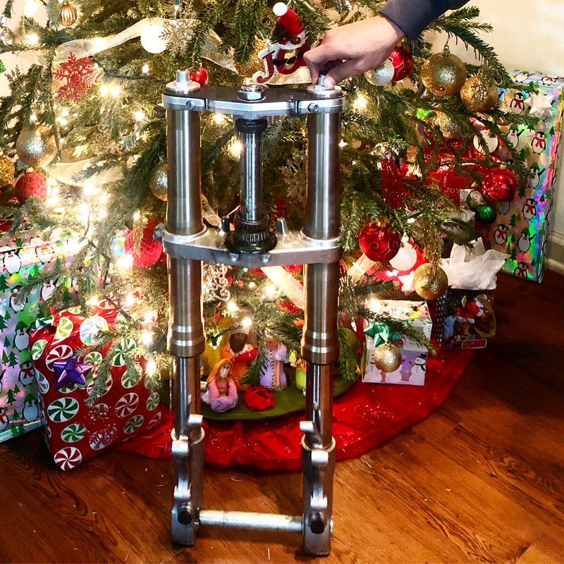

Wife got me a xmas present and i had to open it early
My K75 Mineral Grey Cafe build  3-DDD05-F2-CC85-4787-95-D9-FE211-E0279-C1
My K75 Mineral Grey Cafe build  676-CB1-C7-B396-443-C-BEE6-2-F117558-E968
My K75 Mineral Grey Cafe build  CDF95-C9-E-62-C7-4346-8485-6954-DBDFEB5-D

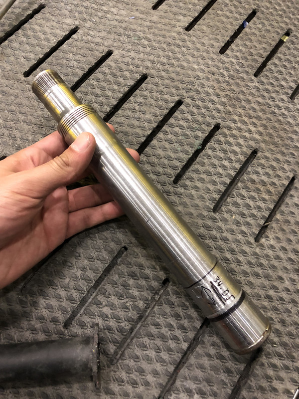

Remove the stem from the ZXR triple tree and  machine to fit the new smaller bearings
My K75 Mineral Grey Cafe build  IMG-2991
My K75 Mineral Grey Cafe build  IMG-3030
I press  the steam with new bearing in to the tree last night and all is  good.

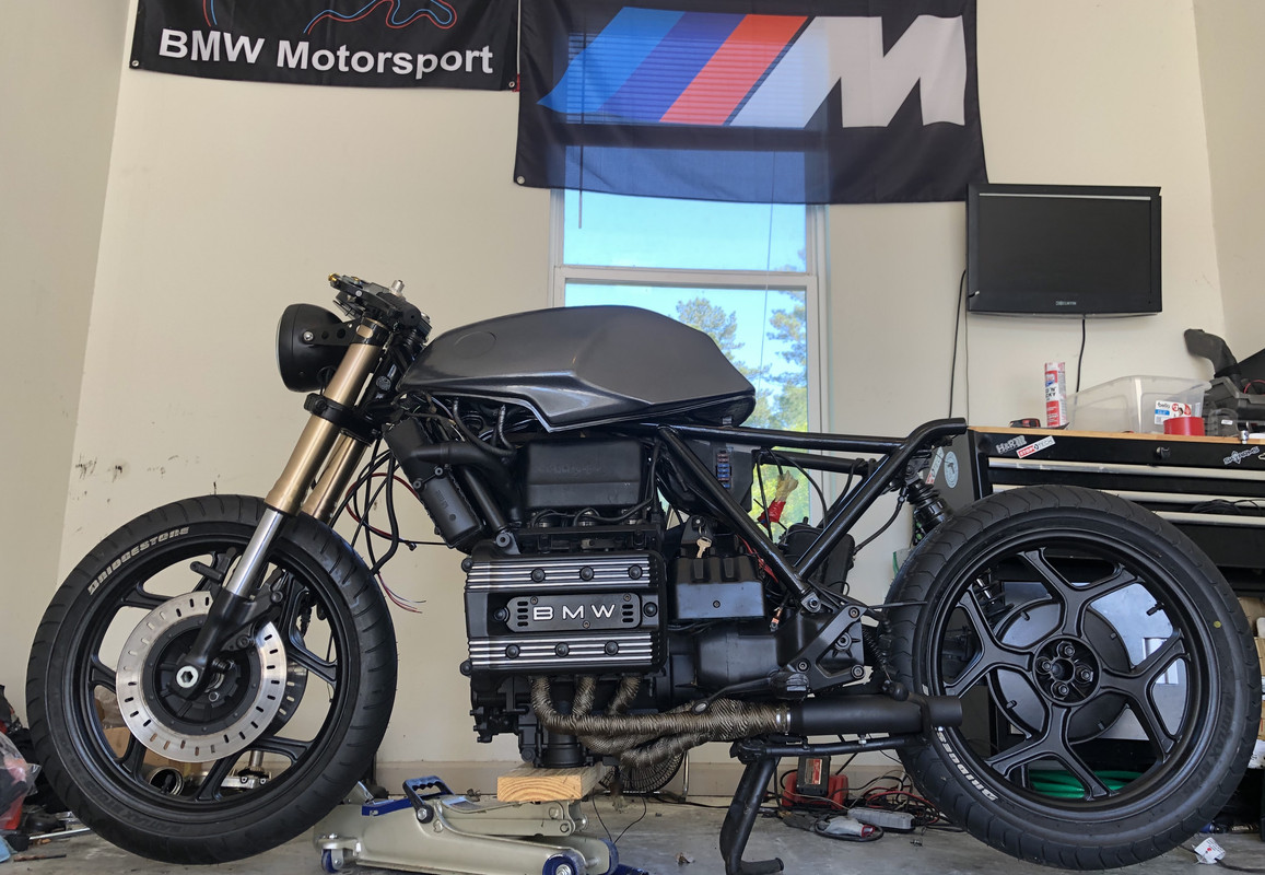

After a day of  alot of swearing  got the forks install
My K75 Mineral Grey Cafe build  EC726-C6-D-999-A-46-BA-86-FC-E3-F71-A822-A94
My K75 Mineral Grey Cafe build  C6-DD3822-D4-BA-4-D7-E-8-C08-00546-C01-DCCE
My K75 Mineral Grey Cafe build  90773463-4-B79-46-BF-8-B13-ECEE66-B757-DB

this past weekend I remove it all for the last time  so I can send the frame and a few bits to powder coat and do some last minutes touches on the engine
My K75 Mineral Grey Cafe build  Zdfhs-rthy-srth
My K75 Mineral Grey Cafe build  Fdbftgnhrh
just waiting on getting it all back from paint and the missing bits from post and hopefully be back on the road by end of may

Those beefy forks are fire! Is it same to say that we can choose the front end of our liking as long as we change out the bearings and stem? A fabricated stem I assume?
1985 BMW K100
8Back to top Go down   My K75 Mineral Grey Cafe build  Empty Re: My K75 Mineral Grey Cafe build on Mon Jul 22, 2019 8:02 pm
There's all sorts of problems to consider: disc size, distance between discs, caliper mounts - the list goes on. There's a bit more machining in that than GR-Racing is letting on - wheel spindle for example. Also, the proximity of the sliders to the tyre suggests that there's no room for a mudguard if you wanted one.
