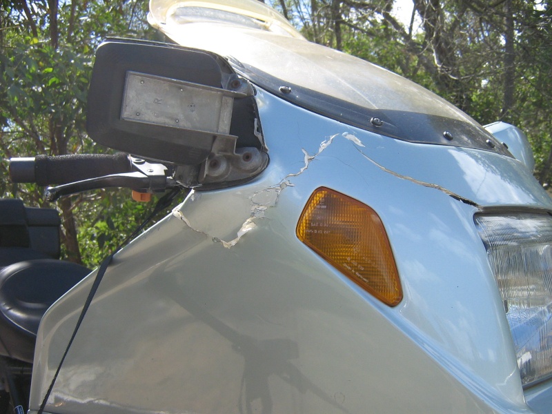

as promised ..here are some pics of "what rocks my sox " at the moment ....its been a long wait !!!85 rt resto ...my attempt ...hey im not into making a show bike ... Pictur13
pickup day ....way out in the country .
after a little investigation ...note the corrosion .....my poor baby needs some tlc 85 rt resto ...my attempt ...hey im not into making a show bike ... Pictur12

btw i borrowed the "work place" dremmel tool today ....and cut a new flat slot groove into that master cylinder brake resevoir retaining screw (brass)that stripped the phillips head socket on top ..found it to "loc-tighted" in ........sweet.... i can now recharge the brakes on the front ..
also allowed me to cut a furrow into the outer of the right hand mirror housing to accomodate the outer shell.... which had a drop event the other day ....the plastic i had glued together durring the repair of the mirrors ..split apart at the first sign of contact with the ground ........hmmm tethers ...yes please 85 rt resto ...my attempt ...hey im not into making a show bike ... Pictur16
i used my gas powered soldering iron to reweld the thermo plastic housing ...with an old computer fan as donor for the filling material ...seems strong ....pics to come85 rt resto ...my attempt ...hey im not into making a show bike ... Pictur17
