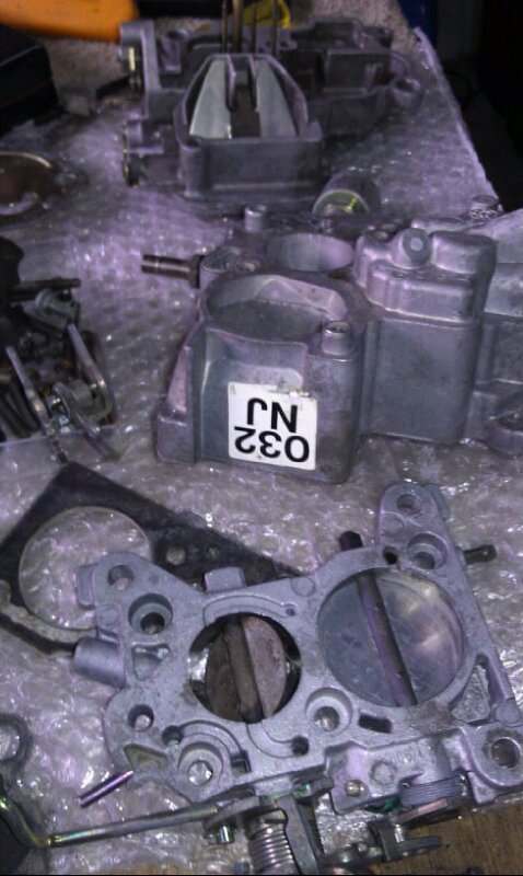

I had an old carby lying around that had some junk in it and on it.
Before...Influenced buy Oldgoat. Ultrasonic cleaner Gunk210
Influenced buy Oldgoat. Ultrasonic cleaner Gunk10
And after ,,Influenced buy Oldgoat. Ultrasonic cleaner After10
Influenced buy Oldgoat. Ultrasonic cleaner Aftera10
Some of the deep cavities stil had some oxidisation and the alloy was stained from age. This can be removed with soda blasting. The valves now all work freely and all springs as well. i am just going to have to wait for a reason to pull bike apart before i can drop some of her parts in. Any really heavy grease needs to washed off first. I have come to teh
conclusion that this is a part of the process that can determine the
results. I dropped one of the foot peg brackets in with car wash and it came up fairly clean. i am sure I have missed a lot, so Any questions please ask.
