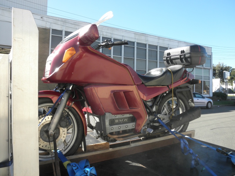

Well it started with the The journey begins P7180011arrivaThe journey begins P7170010l of the bike last night. Some photos.The journey begins P7180012The journey begins P7170011The journey begins P7180014
This photo shows the k3 gear selector and the one we found on K7. The big shifter broke the first time I used it...must have been made for someone with a crook foot or leg. It is in the process of being welded and cut down to a "normal" size. The bike shows 91,000 on the speedo which is not working at the moment. I will check the sender unit, connector, etc next week. Looking forward to much help from many people. It starts, goes and stops....was registered up to week ago. Indications are that it may have been a cop bike.
2Back to top Go down   The journey begins Empty Re: The journey begins Wed Jul 18, 2012 7:19 am
The speedo is a police one but the fairing isn't set up for the engine protection bars so that isn't police. What year is it?
3Back to top Go down   The journey begins Empty Re: The journey begins Wed Jul 18, 2012 7:36 am
One usual give away is whether there are extra holes in the fairing for the police bits and bobs.

Build date is 2/87 and compliance is 9/87. The reason I suspect it is ex police is that it is white inside the ducktail and white where ever there are chips.....although that white may be the base coat. Now the learning starts....blown high beam...do I have to strip the fairing off to get to it?
No holes for the crash bars....I got a free left bar from the wrecker. Anyone have spare right one?
6Back to top Go down   The journey begins Empty Re: The journey begins Wed Jul 18, 2012 8:43 am

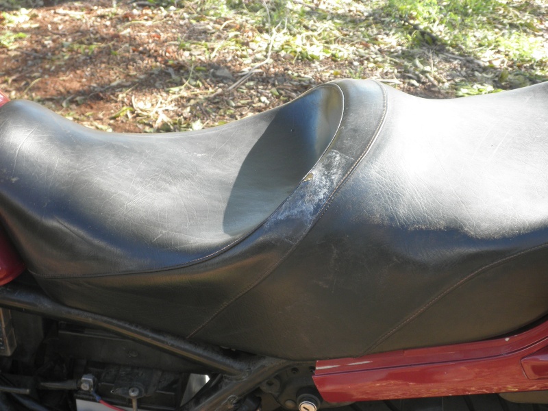

The seat and ducktail have been changed as they are not police. The police originals are a single seat and radio box where the ducktail is.
GITH will be able to find out if you give him the frame and engine numbers.
7Back to top Go down   The journey begins Empty Re: The journey begins Wed Jul 18, 2012 8:59 am
Rick, when will GITH be home? 0094685K100RT is the vin.

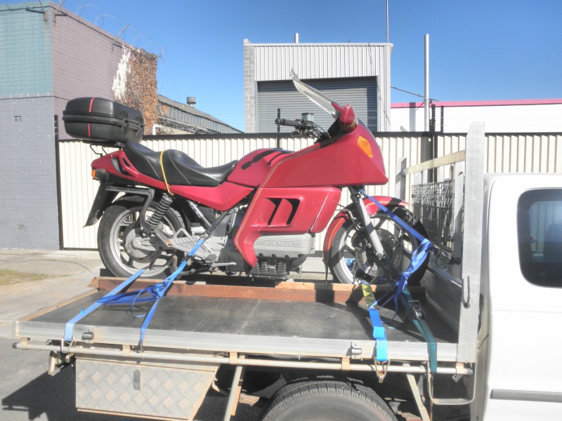

hey stan ....gee you did well with the tie-down process
looks a blast ...have fun ol mate
