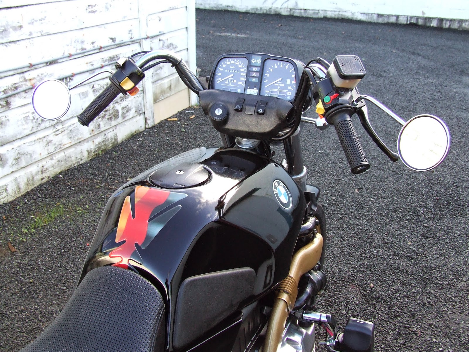

For your bike you might consider getting the gen Bar Risers. I did not have to lengthen any cables.
My original LT bars looked like this:
'89 K100LT >>> K100 CUSTOM CONVERSION - Page 6 DSCF2734
What incensed me to put them on the K was a bike I owned back in 1994, a Honda 750 custom, which had very similar bars. I loved the riding position so much. In fact the only thing I had against that bike was the limited top end (about 175) and the fact that the final drive was chain. Aside from that it was great, a Honda 750k engine in a custom setup
And now I have this:
'89 K100LT >>> K100 CUSTOM CONVERSION - Page 6 DSCF2952
Having recently added a German Flag coloured Tank protector :__))
'89 K100LT >>> K100 CUSTOM CONVERSION - Page 6 DSCF2951
Picking up lots and lots of lookers and interest everywhere it goes
When you consider that it used to look like this:
'89 K100LT >>> K100 CUSTOM CONVERSION - Page 6 130115-1548
After spending 10 months with me it got to the first photo with the LT bars

Well . . . The 2014 / 2015 Riding Season has begun here in NZ properly this week with the changeover to daylight saving, making a HUGE difference in levels of enjoyment and available daylight riding time after work and on weekends etc
The bike got it's 3rd WOF today since the rebuild with nothing needing doing as tyres were refreshed towards the end of last season
I have been mapping the K's since I re-entered the world of motorcycling and it looks like this:
Season 1: October 01 2012 -May 01 2013:
Approximately 30 weekends and 24 destinations covering 7500ks
Off season (Rainy season here. Not as much fun) 10 Destinations covering 2500k's
The bike got repowered January 2013 and I was off the road for 3 weeks but since then its been all good with only a major tune up needed
Here's how it looks today . . . lets see how it ends in 6 months time :-)). I have tenative plans for a small screen and possibly a Radiator shroud and engine sidecovers and a fairing scoop but this remains to be seen. At the moment all I am looking for is doing a LOT of trouble free K's.
'89 K100LT >>> K100 CUSTOM CONVERSION - Page 6 DSCF3078
'89 K100LT >>> K100 CUSTOM CONVERSION - Page 6 DSCF3076'89 K100LT >>> K100 CUSTOM CONVERSION - Page 6 DSCF3077

Good work BM
Is it really that shiney or is it just a clever trick by the foto graffer
Those bars really have me intrigued.
I have no desire (need) for that type of riding position, but it amazes me that no one else has tried it. It seems to be a perfectly obvious thing to try.
On the subject of small screens, not sure on your desire/likeness/ wantness for the naked light and blinkers, but Motorworks sells the kit I have on my bike for very little money.
Headlight surround and speedo mount all in one.
the most expensive part, apart from postage was the bolts/scres/ wahsers I ordered to fit it together.
Search motorworks for
STK59490 20gbp
STK59374 12gbp
I have seen quite a few screens that will fit this type of headlight arrangement
275Back to top Go down   '89 K100LT >>> K100 CUSTOM CONVERSION - Page 6 Empty Re: '89 K100LT >>> K100 CUSTOM CONVERSION on Tue Sep 30, 2014 11:15 am
Be made
Be made
@rosskko wrote:Good work BM
STK59490 20gbp
STK59374 12gbp
Thanks for the comp.
Yes, it really is that shiny, shine created by something called  (trade secret coming out here! )  . . .  . .Neopol
