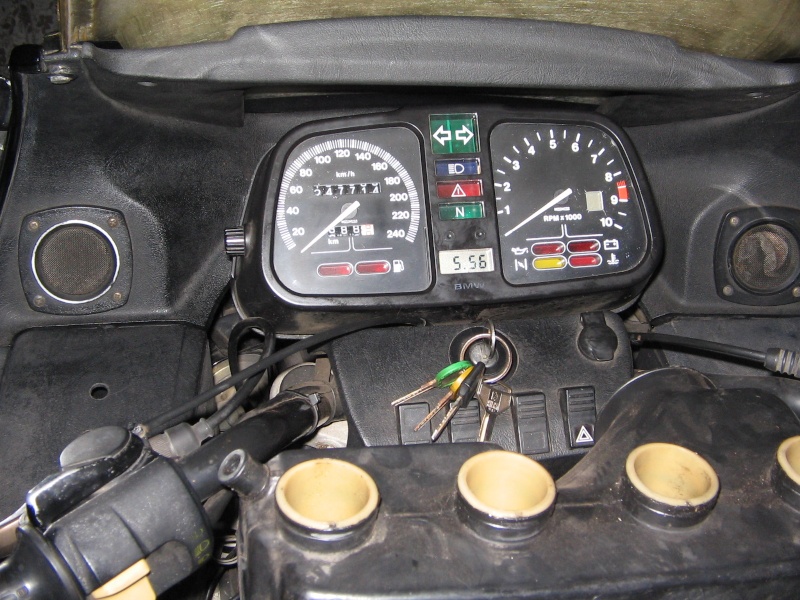

The frame says Lt, the bars say LT, the fairing says RT, the glovebox surrounds say AAAAAAARRRGH holes everywhere. I'm not sure, when I get my glasses on and in sunlight I might get the vin number sorted.

The plenum has been removed so that the old owner can sprinkle some fuel in and crank it up, god forbid some crap went in there over the last few days.
