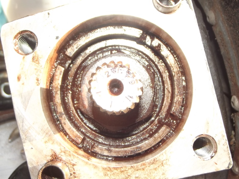

Now I reckon the splines on the driveshaft are knacked but the diff is just about ok. But, then again, that could me lying to myself again. Any thoughts would be gratefully received. Can anyone recommend anywhere in the UK to get this work done by any chance? I have heard Motobins do a refurb but is there anywhere else? Thanks for looking.

those splines look quite worn ....
and my guess, will cause a new tail shaft to look like that old one pretty soon
I had a tailshaft that was a repaired one with that reweld process new outer spline ...
 but when installed still had a fair bit of movement ...meaning it seemed to a close fit ...not a tight one, some 60,000 ks and its toast.
don't know in fact that the add on section was indeed the same that motoworks etc sells ...but worth investigating a bit further .
have replaced the shaft with a original bmw unit and its tighter than repaired shaft ever was  ...wonder if there is a slight difference between the rewelded add on spline and the bmw units ...

They both look no good, not sure there are any refurb guys in the UK, if you have no luck PM me, i have a good diff and its original drive shaft from a late low miles (1990) K100rt, £95 the pair.

Thanks for replies; ok, my bits have lost their usefulness.
Ben, I'll be making contact, that's a great offer, thank you.
