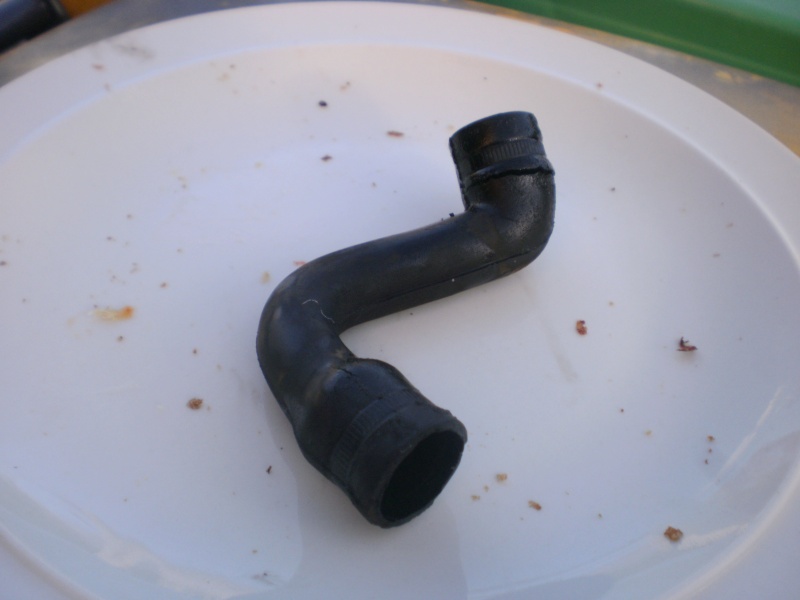

Young Warren had a problem. Seems his hose was split.
He ordered a new one (once again cheaper from UK than Sydney) and duly arrived at my house to install it.
Looks like the diagnosis was correct.
Gearbox Breather with Warren C P2250211
Lucky there happened to be a spare K just lying around with a nice pair of hose clamps as someone forgot to order theirs and the one use cable ties were not going back on.
So that was 10 minutes gone. Next?

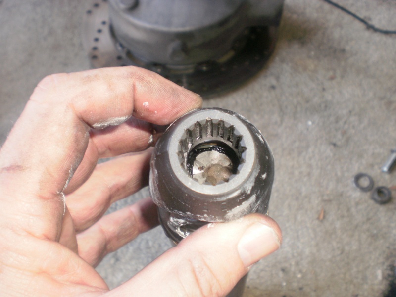

Spline lube. Looks brand new.
Gearbox Breather with Warren C P2250212
Gearbox Breather with Warren C P2250213
Only issue was a small amount of oil on the final drive that did not extend up the swing arm. Seal?
And with the excitement of scones and jam and cream and tea and moly grease we forgot to check the oil level in the FD.

Let them leak a bit of oil slopping around there can only be good for the splines.
Now I cant remember where I read it but not very long ago (long after my pet dinosaur died) I read a bit about putting 150-200ml of gear oil in the swinging arm to lube the spline. First you need to clean the whole lot and make sure the bellows at the uni are in good condition.

Now where were we, oh yeah Warren C, I put a new S hose on 3 years ago and it went belly up in Feb this year, not sure why that would happen.

i had leaky pinion seal in my fd a few yrs ago and took the fd to dealer to install it.
they have the big $$ factory socket tool that fits the 4 slot piece in there.
only a 1/2 hr labor.
i read somewheres the a small leak is OK and lubes the splines too
