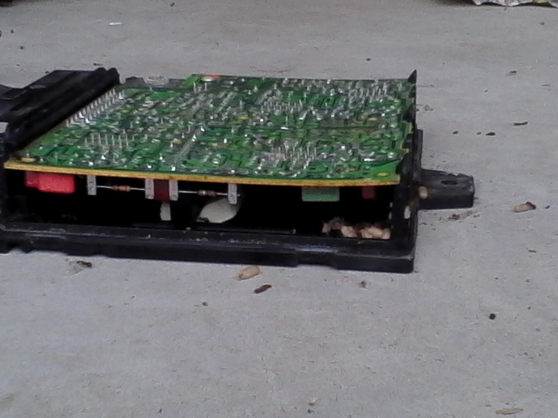

Next i pulled the jetronic unit out and noticed drain holes in bottom plastic plate were clogged?
Opened the cover of the jetronic and a nest of fire ants came boiling out—lots of eggs and ants, dead ants and dirt.
Cleaned the board and inspected solder joints and traces—no sign of trace damage, a few cold solder joints touched up with hot iron; cleaned board with alkyhawl and it looked brand new.
L-Jetronic computer bugs, fire (ants) in the hole Cold_s10
Put it back in and got the same result—no start, very little fuel squirting out injectors.
Got another jetronic unit and swapped it out—fired up immediately upon hitting the start button!
Maybe need to modify the flowchart to check for bugs in the computer…

Yep - looking at the curvature on that board I'd say there's more than one micro-crack somewhere.
Yeah i was looking at that thinking it may have been some moisture from the ant nest
