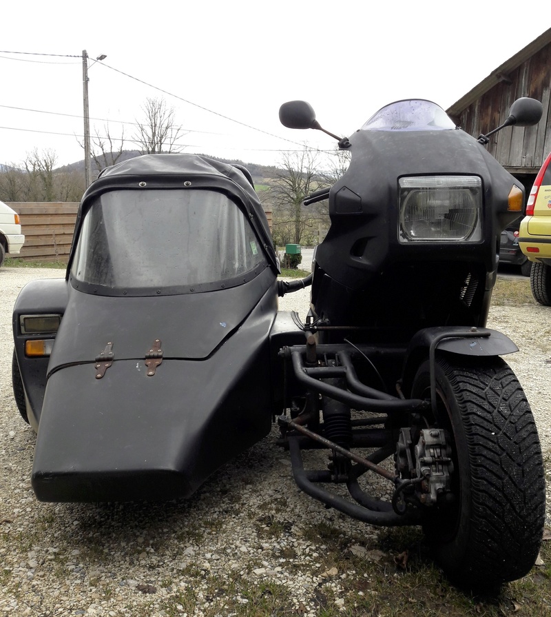

Hey, I just realised that I had not posted pics of my recently acquired K1 sidecar.
I love K1, and sidecars.
I ride sidecars for 20 years now, I still have an old sidecar, a bitza made of R60 frame, R60/5 engine with R80 cylinders and heads, /6 body and a Jewell chair.
The k1 was an old dream I eventually realized 2 years ago, with a full restoration.
And I was looking for a K bike sidecar, due to its reliability and its mechanical design that fits this use.
Then, 2 month ago, I saw an ad on a website for a used K1 with a Panda sidecar.
No time for reflexion...but no money. I immediately sold my 600 XT Ténéré and Toro tilting sidecar and, once that financial matter resolved,  bought the K1.
OK, it looks...strange.
Rusty K1 sidecar 20170312Rusty K1 sidecar 20170311Rusty K1 sidecar 20170313
Looks like I won't have a price at Peeble Beach this year.

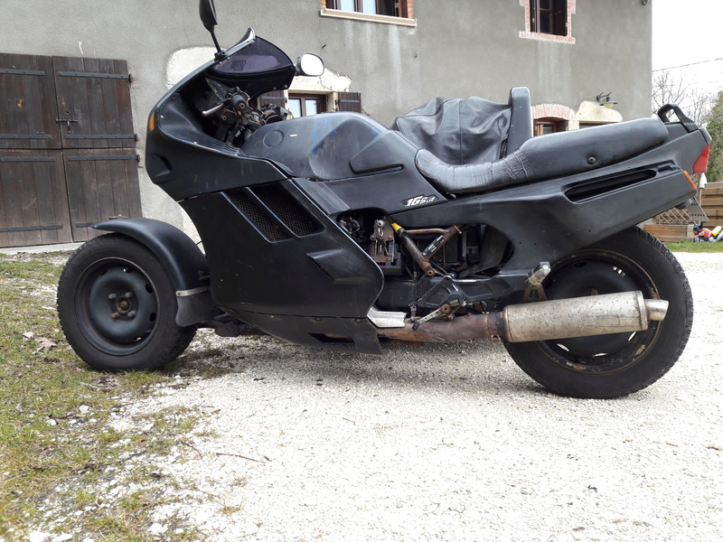

The rig was used mainly in winter, on salty roads. So its very, very rusted. In fact I never saw so much rust on a bike!
The body was quickly painted in mat black, to hide the defects of the original blue paint, and to match the corroded parts in alloy.
When a friend looked at it for the first time, he asked me if it had burned...
But, in spite of its rats look, and of the 220 000 km on the tacho, it runs like hell!
The engine is perfect, transmission also. Good suspensions (Fournales at rear, Ohlins on the side, Kawasaki GTR air shock in front) and the multi linked front end made by BCS, a former french maker, combine with the large width to provide excellent stability and grip. It's almost impossible to lift the front wheel, even on purpose, and the front wheel remains stuck on the tar with this design.
The 3 brakes had suffered from the winter use, and the master cylinders need an overhaul because it's not very powerful.
So...I'll have to make a full paintjob on it, because usually kids are smiling when they see a sidecar, but this one scares them if they're not Batman fans.
A lot of work to do, with a complete dismantling, sanding and painting. Not today, that will wait next winter!

How does it turn?  Looks like the front wheel is fixed by those trellis frames going to the side car.  Shocked

MIBrick wrote:How does it turn?  Looks like the front wheel is fixed by those trellis frames going to the side car.  Shocked
Lok up 'hub centre [or center] steering'.
You're right, that's the way it's made.
The treillis frame supports the parallel swinging arms which provides suspension. The direction is made by a car hub, on two pivots, operated by a multi link device from the bar.
It would easily support an electric assistance, by the way.
A lot of work to do, yes, but I've already made such restorations. And it won't be blue but red, to match my solo K1. And honestly: a K1 is red & yellow.
For this time, I'm trying to find the missing parts, glovboxes lid and bar cover.
I had found all these parts 2 months ago in Germany, but the postal service has destroyed the parcel...no idea why and no hope to see my parts or my money back.
If anyone has these to sell, let me know!
I'm also searching new wheels, three spoke Ronal rims that wil remember the original design of the genuine wheels. Not easy to find neither, but I think I've just found what I needed.
The exhaust system will be changed, this one is ugly, noisy and makes difficult changing the rear wheel.
I'll pass the new one between the bike and the sidecar so it won't be a problem.
The rear bevel will also be swapped for a K1100LT one, shorter, to cope with the extra weight and make the K1 more nervous. I'll never attempt to reach 200km/h with, anyway.
So...next winter, maybe?
But maybe I'll change my mind and make a LT conversion, because I have a donor bike and it will be more adequate with my use.
