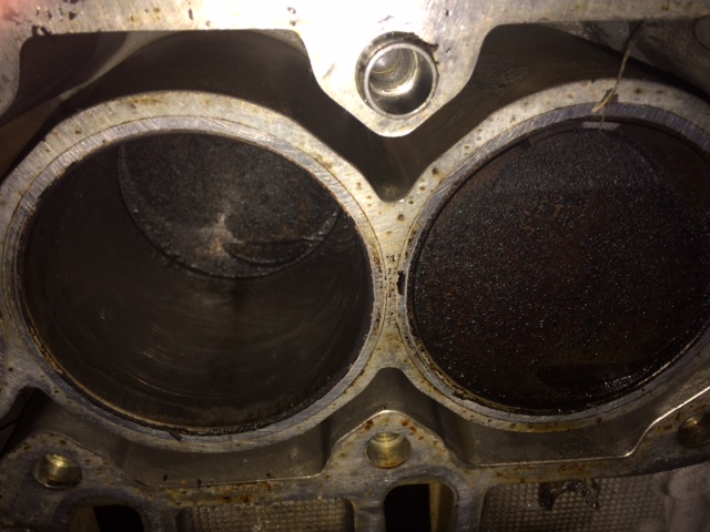

Hello, all.  Started with assumption that I'd reshim valves, but I didn't expect that would solve my oil burning issue.  Took head off, cleaned valves and depressions up a bit.  Tested valves via the water/compressed air method.  No bubbles at all.  The cylinders look pretty scratched up and the throttle bodies butterfly valves look really crusty to my untrained eye.  I wager that this is a hone+rings job.  What else am I missing.  Why would the throttle body valves be so crusty?  Pics follow.
Crusty interior bits Img_1113
Crusty interior bits Img_1116
Crusty interior bits Img_1115
Crusty interior bits Img_1112
Crusty interior bits Img_1114

cant see the bores that well ...just a lighting issue I guess
but do I see some score marks around the bore ?  down a bit ..? or is it just oil marks ?
don't forget these bores are a nicasil coating ...not steel   so ask questions before going in there to try to refinish them
the throttle bodies do clag up a bit as a natural occurrence ..( the valve overlap spits back a fair bit of carbon crap )
get in there with some throttle body cleaner  for the tbs '
and or perhaps you have a fair bit of leakage of the rubbers from the throttle bodies to the plenum (box that sits on top ) and the crankcase to plenum z type  tube ...often found to be cracked and leaky
perhaps you can add a light for the bores pic ? after you wipe out the cylinder with a degreaser soaked cloth ??

Looked in the bores again and, indeed, all the marks are on diagonal and crisscross, so that's all original.  Is there a way to tell whether the rings are shot without removing all the pistons and with the engine apart?

FreyZI wrote:Looked in the bores again and, indeed, all the marks are on diagonal and crisscross, so that's all original.  Is there a way to tell whether the rings are shot without removing all the pistons and with the engine apart?
Are you burning a lot of oil(more than a quart in 800 miles)?  If so, you have your answer.
