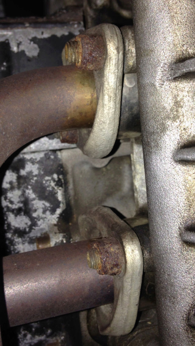

In it he writes about the exhaust header mounting bolts basically disintegrating as he tried to remove the headers. I realized that I never looked at mine upon taking ownership of my K. (Oops)
I went and stuck my head under the bike and snapped a few picks. I can't tell if these nuts and bolts are too far gone to try to remove. I'm going to give them a light scrub with a soft copper wire brush and see if if there is any shiny metal under or if it's rusted deep.
Exhaust Headers, should I be concerned Img_0011
Exhaust Headers, should I be concerned Img_0012
Exhaust Headers, should I be concerned Img_0013
Exhaust Headers, should I be concerned Img_0010
Exhaust Headers, should I be concerned Img_0014
Exhaust Headers, should I be concerned Img_0015
They look absolutely normal to me - leave them alone unless you need to remove the pipes.
Located in a pretty crappy place with everything the road can throw up at them combined with some significant thermal cycles in normal use, they will corrode to some degree.If you wire brush them up, they'll only develop a new rusty coat in a very short time.
If you do need to remove the pipes, make sure that you've got spare nuts and studs (and gaskets) available - the nuts won't be re-usable, the studs might (with a little dressing up).

They'll probably unscrew from the head intact if you attempt to remove them, even after a good shot of quality penetrant. They're available from BMW but a length of 8mm x 1.25 pitch threaded stock can be cut into your desired lengths and then a good quality crush nut replaces the OEM copper version.
OEM shouldered Stud x 8 - 07 12 9 903 964 or 07 12 9 908 133
OEM Nut  x 8 - 11 62 1 744 323
Crush gaskets x 4 - 11 62 7 662 083

Do I need to remove them?.. well....sort of. As part of establishing a maintenance foundation and cleaning out the bike (somewhat thoroughly), I am wanting to replace rusty and corroded stuff with new shiny stuff not so much for fashion but for peace of mind (as much as possible). At the beginning of October I am putting the K up on a block and taking stuff off (tank, seat, rims, forks, and electrical) for the deep clean and resemble. (that's the plan at least). So I am assessing and ordering parts as I find things I want/need to switch out.
Thanks for the part numbers. That is super helpful. I was not sure if those bolts were fused with the header or replaceable. I feel better knowing they can be replaced and I don't need to buy a new block (which I am not inclined to do).
I like this bike and the inner workings were well maintained by the previous owner. They never cleaned it though and it shows on certain sections of the bike.
They're not bolts, they're chrushable nuts spun onto threaded studs, and those nuts tend to make themselves part of the studs due to heat and corrosion. Only remove them if you need to. If there are no leaks, why bother?

They're 'Phildas' nuts - the recommendation is to use them not more than five times - if they're in good condition and if you can get them off...
http://www.bolts-nuts-washers.com/philidas%20nuts.htm
If and when you do have to remove them spray them with a 50-50 mix of acetone and ATM fluid. let them soak and repeat a few times. It will give you a better chance of actually removing without damage, but not guaranteed.

Yes... this is my concern. If I unscrew the nuts, (yes, you may giggle at that phrasing), will it snap a stud off? This is what I am trying to determine.
But it looks as if those studs are replaceable. Am I understanding correctly?
I feel that Ultimately (at some point) this will need attention. Do I take a chance now and replace rusty parts (on the hope that it's not rusted that deep) or wait until it completely rots out and then I have to replace the block (which I simply can't afford to later)?
Vitamin K wrote:...it looks as if those studs are replaceable. Am I understanding correctly?
The part number for replacements studs is in my first reply. There's no reason to replace a block if a stud snaps, which it's unlikely to do. In most cases if you have enough bite on the rusty bit - that once resembled a nut - the studs will unscrew with the nut attached. You then either run a tap through the threads to clean them up or simply screw in new studs. Even in the unlikely event of a stud snapping off there's always Ez-Outs and other methods of removing broken remainders from the threaded hole.
