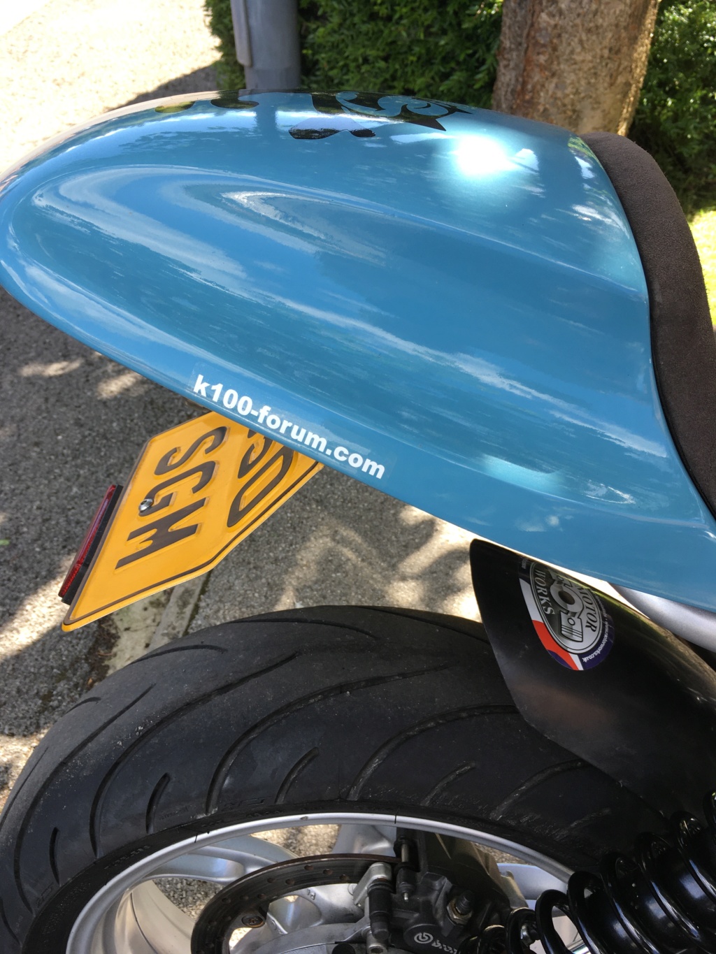

A bit of livery
As a blue entity, the thing was very plain. So I incorporated some stick-on reading material:
K75kforkurz - Page 8 05110
K75kforkurz - Page 8 05910
