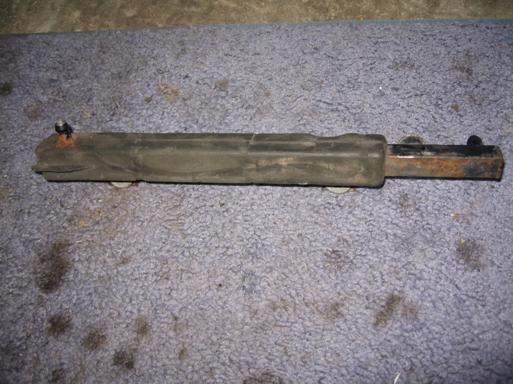

MartinW wrote:...The source of heat in the engine comes from the combustion  of fuel in the cylinder head. Besides the  injectors which are partially insulated from the rail ( no metal to metal contact) the main entry of heat into the fuel has to be via the fuel rail. If you insulate the FPR and the lines and shield or insulate the rail you should eliminate most of the sources of heat entering your fuel system...And I could be mistaken but weren't some Bricks at some stage fitted with insulation over the fuel rail. Not sure whether this was OEM or aftermarket.
Martin,
Interesting post...
On my K100LTs (2 + donor), all the fuel rails are insulated, so I suspect that this is an OEM fit as standard. These are all European models, so not designed for running in especially hot climates. The insulation is easier to see in the pics of the fuel rail off my donor bike (yes, it is awaiting the paint treatment).
The insulation effectively wraps 3 sides of the rail and just clips around the bottom side (about 3-4 mm thick).
Pic 1: Underside (uninsulated)
Overheating Fuel Solution Mk1 & New Improved Mk2. Img_9110
Pic 2: Fuel rail top side (held in as-fitted orientation with those come in handy ear plugs)
Overheating Fuel Solution Mk1 & New Improved Mk2. Img_9111
Pic 3: Outboard side (furthest from engine)
Overheating Fuel Solution Mk1 & New Improved Mk2. Img_9215
Pic 4: Underside of rail (held in vertical orientation)
Overheating Fuel Solution Mk1 & New Improved Mk2. Img_9213
...and a few blurry pics
Pic 5: As fitted. Aft end of fuel rail not insulated and external to fairing lower assembly)
Overheating Fuel Solution Mk1 & New Improved Mk2. Img_9212
Pic 6: Centre section of fuel rail as viewed between lower left rear fairing vent
Overheating Fuel Solution Mk1 & New Improved Mk2. Img_9211
Pic 7: Fwd end of fuel rail as viewed through front left fairing vent
Overheating Fuel Solution Mk1 & New Improved Mk2. Img_9214
It makes sense that the heat in the fuel is being picked up as it is circulated through the fuel rail. The fuel pump and Fuel Pressure Regulator should ensure that the fuel rail is always full of fuel under pressure, which either is squirted into the cylinders when the fuel injectors open and burns (creating power and waste heat from combustion) or is sent back to the fuel tank via the return line.  Once the engine block is up to normal temperature, with little natural air cooling (particularly on fully faired bike) in the vicinity of the fuel rail, it is not surprising that the fuel rail also heats up - mostly though convection (being surrounded by hot air) rather than by conduction (metal to metal contact) as the two mounting bolts are insulated from the fuel rail (as shown in blurry pic 4 above) and, therefore, the fuel within the fuel rail will also heat up. The now heated surplus fuel returns to the fuel tank where it will mix with the, initially cooler, bulk volume. After a period riding, the temperature of the fuel in the tank will start to increase due to the constant flow of hot fuel back to the tank - and the longer you ride, the volume of fuel in the tank will steadily reduce, which means the remaining fuel is going thorough the pump-rail-return cycle more frequently and therefore getting steadily hotter. Of course it can never get hotter that the engine block temperature, but that is unpleasantly hot and this will be noticed by the rider as the fuel tank starts getting above 45 deg C.

Mine has the insulation on the fuel rail but it only covers 3/4 of the rail, almost like it was designed for a K75
K100rt ex plod bike 5/1990.
I have no problem with authority. Just some of the morons that are paid to enforce it.
just a word of advice marc ,  take the insulation off and check the rail for corrosion , and pits in the metal
have seen a couple near eaten through    after cleaning and stabilizing-filling   the insulation can go back on
