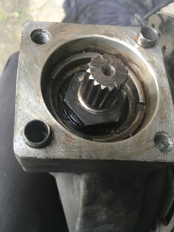

Another spline question 381ea710 Ok here’s my final drive splines..they look good .....2 things...can u use gasoline to clean before I lube? And all the gunk that’s in the housing , coups I just squirt degreaser in there? I don’t wanna ruin any seals ..and the red stuff is obviously a sealent ...should I leave it there?....I’m doing this now ....thanks

Better pics

Gasoline, kerosene (is best), denatured alcohol, brake cleaner, a good degreaser all work
It can't hurt to leave the sealant to keep out water or apply a new bead
Be on the look out for a another 16 tooth drive shaft

Thanks...I decided not to pull out the drive shaft and lube it ....next tire change...I don’t wanna go thru the hassle of pulling out and re-aligning....I feel like since it’s my first time I might have a issue and I was told it’s probably fine anyways
@volador wrote:Gasoline, kerosene (is best), denatured alcohol, brake cleaner, a good degreaser all work

@volador wrote:Be on the look out for a another 16 tooth drive shaft
Why? They last much, much longer than the Z20 ones.

Good to have a spare on hand

You can renew the splines. Cut off the old ones and weld on a new set from Motobins.
8Back to top Go down   Another spline question Empty Re: Another spline question on Thu Jun 13, 2019 11:19 pm
I have heard of people replacing the u-joint.  I have found the part number in the past and they are available for about $28.  Any shop that does drive shafts should be able to do the machine work.
