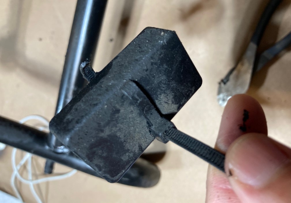

While disassembling my 1993 K75 project bike I came across this object zip-tied to the center portion of the center stand mounting bracket. It has no markings on it at all.  It's magnetic enough to stick to the refrigerator door easily (but not super strong like a neodymium magnet). It doesn't seem to be in a position to somehow trigger any sensor and it certainly is not holding up the center stand cross bar.  Whatever it is (was) it seems to be serving no more purpose. Was thinking maybe some kind of sensor for an aftermarket alarm or something but that's just a guess. I took it off to clean up the center stand and was about to dissect it to see what's inside (besides a big magnet), but I thought I'd first throw this mystery challenge out to you guys for fun. Any guesses?

Some people fitted them under motorcycles to help activate the traffic light change. They were supposed to activate the coil of wire imbedded in the asphalt at traffic lights. I used to have problems activating certain lights and I got in trouble for dismounting at one particular set of lights and activating the pedestrian button. I had been watching him watching me after sitting through four light changes. A long and interesting argument ensued he was going to book me.

Another hypothesis: it could be a cure for weak springs, to make the stand stick to its support.
Or a very optimistic system to prevent puncture by magnetising nails before they hit the rear tyre. Smile

A similar devise is fitted on steel hull boats to reduce/prevent corrosion, just a wild guess  scratch

I'm now far enough removed from that job to admit this: multiple decades ago I used to design traffic systems. The problem you had there Martin was that the detector loops for that traffic lane had drifted out of tune. I have no idea about Aussie law but had that been the case in the UK and the problem had been reported to the local traffic authorities, yon peeler wouldn't have had a leg to stand on. I had a similar problem when on late shift in Belfast and spent weeks jumping a red light even after I'd reported it; then one night it myseriously started detecting LFB again.
You're right about the magnet; I recall them being on sale. They don't work of course as the detector loops rely on a magnetic field being disturbed by a mass of steel passing overhead.
@Moriati: that's a big chunk of zinc called a sacrificial anode and it has to be bonded to the hulll. I have some not-so-fond (but somewhat interesting!) memories of changing two sacrificial anodes on a boat in about ten feet of water. It took an hour to change one and I used up almost a full bottle of air doing it. I also came up with a real appreciation of the problems that NASA had to solve for working in weightless conditions.

Can it be opened?  I recall spare key carriers that had magnetic cases that you could attach under a rocker panel or wheel well.  I
f it isn't one of the signal triggers it might be a key case.  Strange place to put it, though.

It supposedly triggers traffic lights.
https://motorbikewriter.com/mythbusting-green-light-trigger/
Many states have laws to address the issue of motorcycles not being able to trigger traffic light sensors. Since you're in Seattle it might be handy to know that RCW 46.61.184 provides for motorcycles to proceed with caution after one failed cycle:
https://apps.leg.wa.gov/rcw/default.aspx?cite=46.61.184

Thanks guys. Traffic Light Trigger Magnet it is!
