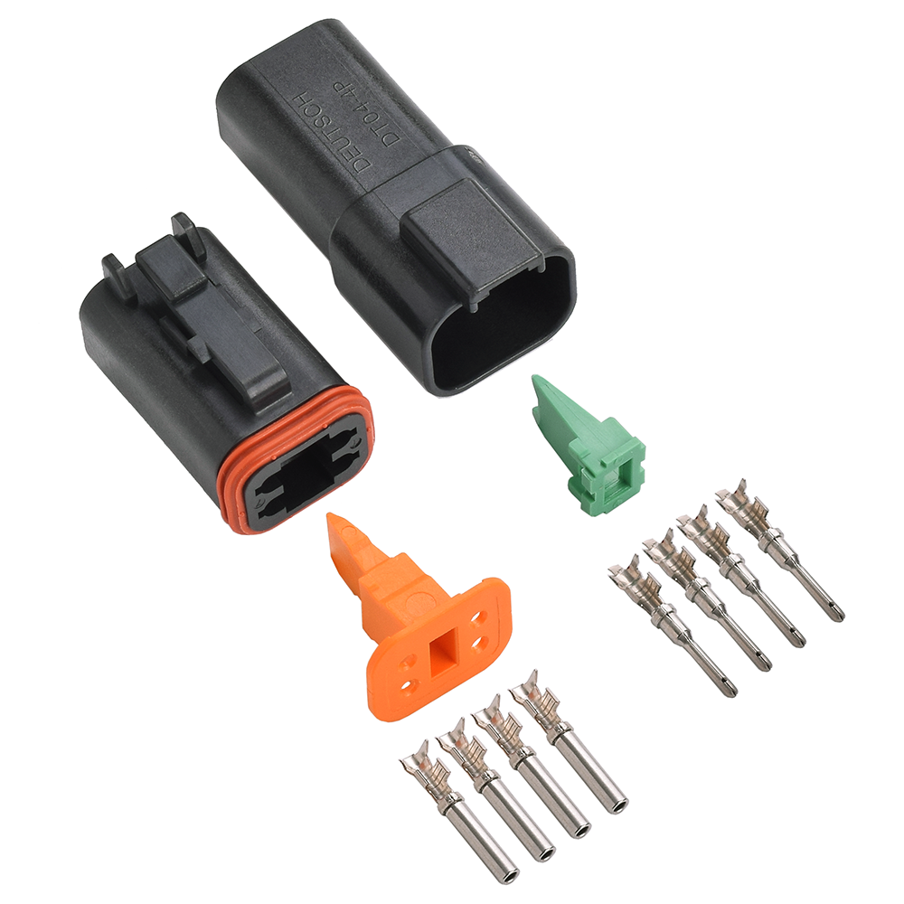

Before I would recomend the Superseal replacement, but as it is a flat inline connector, now I recomend the Deutsch connector.
Take the 4-pin black with stamped terminals.
K1100 LT ABSI 1993 - Trouble with Fuel pump DT4-N-SF-BK
Simply crimp them whith cheap AMP pliers;
