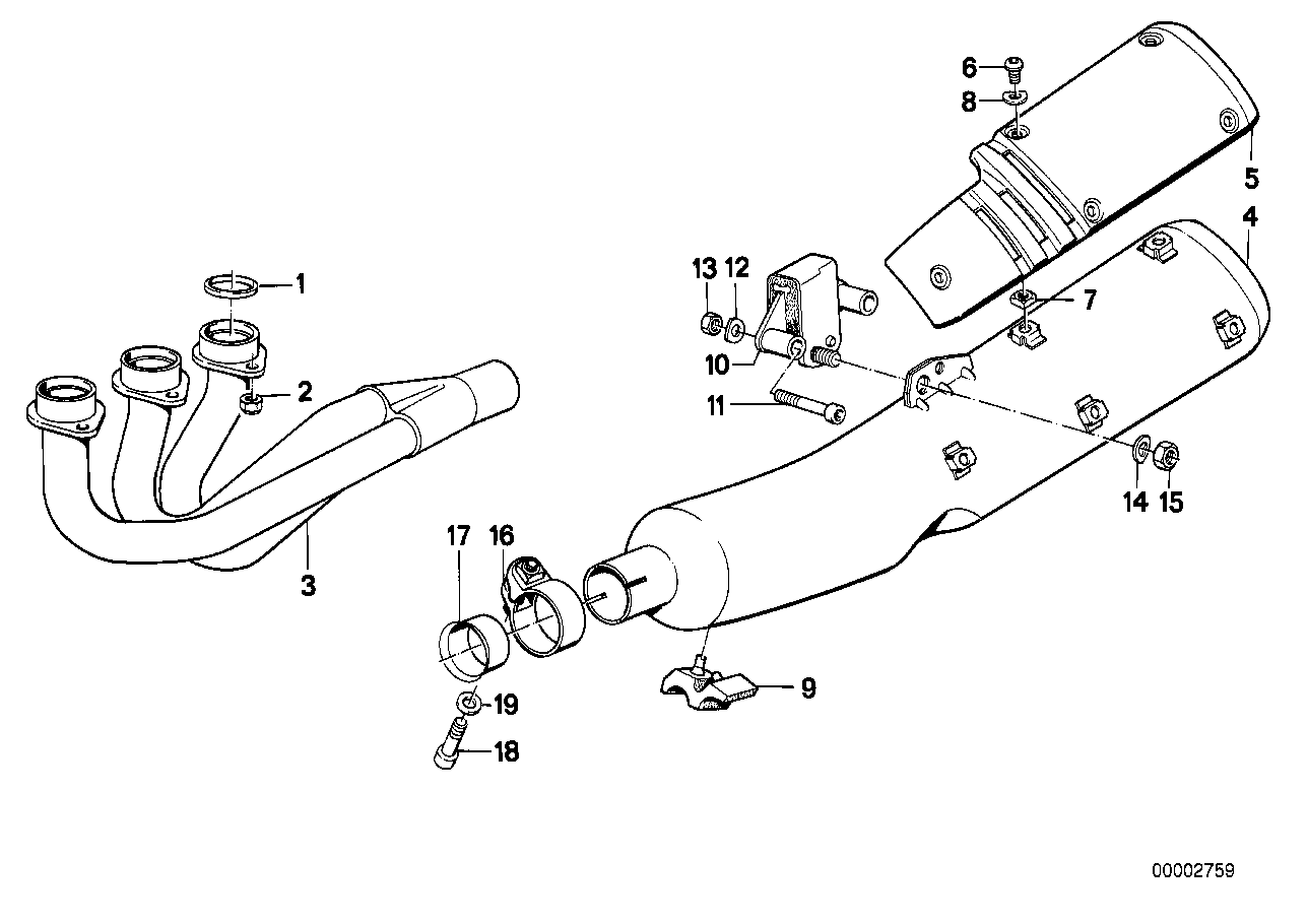

If it helps you feel better, just think of the smoke as mosquito fog and you are doing the neighborhood a service.
18Back to top Go down   K75C project - sort of runs. Empty Re: K75C project - sort of runs. Thu Apr 27, 2023 4:57 am
Rockman wrote:Yes I expect it will clear up with a good run. I half suspect most of the oil is in the muffler because it doesnt smoke much at all when first started, its only after everything has heated up that I get smoke. I suppose I could take the muffler off and run it without. If its the muffler then it should be fairly clear - or maybe I'll just go for a ride next weekend Very Happy
Ride it....you will spend more time trying to get the muffler off and back on. It may well be that whoever laid it up put oil in the muffler like we use to do with our old Japanese bikes but they had steel and not stainless steel.
1983 K100RS 0004449 Odette R100 colours 58,000 miles. Sprint fairing now 59,460 miles
19Back to top Go down   K75C project - sort of runs. Empty Re: K75C project - sort of runs. Thu Apr 27, 2023 8:41 am
K75 headers aren't like K100 headers with separate pipes going into the exhaust can. K75 headers are welded to a collector and much easier than a K100 to attach to the exhaust can. However, they do have a proprietary one use gasket (17) that usually needs to be replaced.
K75C project - sort of runs. Diag_24n
20Back to top Go down   K75C project - sort of runs. Empty Re: K75C project - sort of runs. Thu Apr 27, 2023 7:40 pm
Rockman
I doubt that it was "laid up". Just parked in the back of a shed and forgotten more like.
No I'm not going to touch the exhaust, just ride it and see what happens. It starts easily and runs well so I dont think there is anything wrong, and it has moved the mosquitos out of my shed, which is a good thing.
