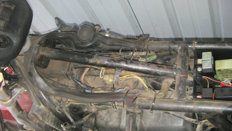

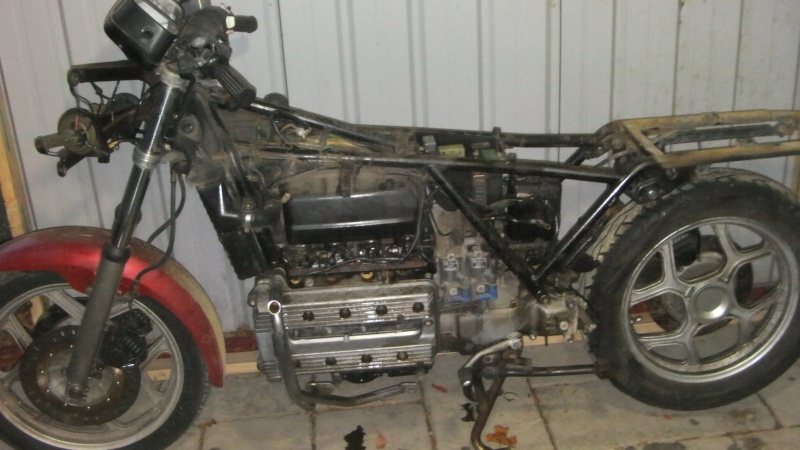

The stripdown
My 84 K100 RS restoration Sany0010
My 84 K100 RS restoration Sany0011
My 84 K100 RS restoration Sany0012
My 84 K100 RS restoration Sany0013
My 84 K100 RS restoration Sany0014

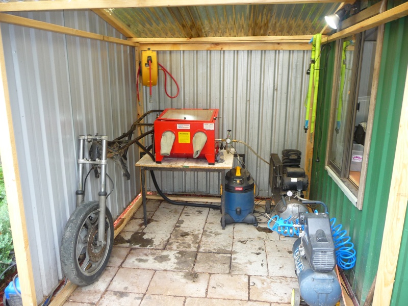

Unfortunetly for me it was the original pump inners seen by the cast impeller and the nut on the shaft not a bolt in the shaft. Had to order the shaft pressed impeller and the new ceramic seal kit from Motobins very reasonable pricing from them the prices locally were criminal.
Now the healing begins cheers because most of the bits are very weather beaten I set myself up with the following
My 84 K100 RS restoration P1030710

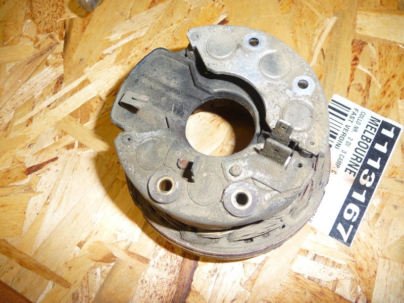

Shown here is the alternator
Before
My 84 K100 RS restoration Dscf0123
My 84 K100 RS restoration P1030712
My 84 K100 RS restoration P1030713
After
My 84 K100 RS restoration P1030711
My 84 K100 RS restoration P1030714
My 84 K100 RS restoration P1030715
Result looks ok however I have ordered a ultrasonic cleaner like OG and I will see what that does for me OG has had some spectucalur results.
I will try VHT clear enamel on all parts at some stage in the near future has anyone had success with it on aluminuim parts?

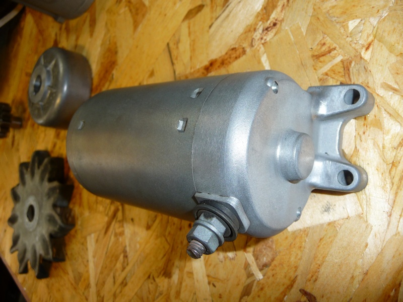

Also pulled apart the starter motor and regreased the bearing and cleaned up
My 84 K100 RS restoration P1030716
The sandblaster can be as bad as it is good no one want abrasives in the machinical parts I have been experimenting with mould release first then silicon below is a injector before and after

Looks like you mean business Jason. One thing I found out a while ago is with those sand blaster guns if the tube that goes to the tub is a thin walled rubber get a plastic reinforced tube as the rubber one sometimes collapses wiyh the vacuum from the venturi and stops the flow of medium.
28Back to top Go down   My 84 K100 RS restoration Empty Soda blaster a rainy day project Sat Mar 03, 2012 1:33 am
Halo
Halo
Thanks for the advice Kfreak yes I checked the tube looks pretty thick
Almost finished the Sodablaster it turned out fairly large I had some perspex laying around and used it for the top

Thanks charlie do you think the USC will do a better finish?

I see the ultrasonic cleaner as being best benefit in small holes/ports/chambers where crud has built up and there is no way for the soda to get in there ...same for threaded sections into body of device etc ,
i would imagine the cleaning fluid used in the usc would be dependant on the job also ..
maybe concider them both as complementary to each other ...if that makes sence (eg the usc would clean out the air bypass ports quit well through the tbs but best left for last after all the big stuff has been blasted off)
34Back to top Go down   My 84 K100 RS restoration Empty Re: My 84 K100 RS restoration Sun Mar 04, 2012 2:29 am
Halo
Halo
Yes agreed thanks Charlie

Halo
Halo
You guys, the thing is I wanted to do this project as it was a break from my electronic designs in my day job but it's all good and I will help out where I can. If we can keep it to K100's it would be a bonus though.
I'm still buzzing over what a good job the soda blaster does the finish is good and I don't have to stress about the foreign matter doing damage think I will try it on the engine block as I have the parts now and need to start to put her back together do you think I need to take the head off to have a look it's got 101 thousand k's on her Question Question

halo_player wrote:You guys, the thing is I wanted to do this project as it was a break from my electronic designs in my day job but it's all good and I will help out where I can. If we can keep it to K100's it would be a bonus though.
I would leave well alone. There are many bricks around that have done 3 times that distance and never been touched. Maybe just retorque it when the engine is still warm but do one bolt at a time. Like back it off pull it out and apply some antisieze on the thread and under the bolt head and then pull it up again.
