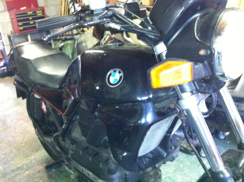

A week tucked up in bed with a chest infection and a laptop can be a dangerous thing!
Well as a result and as the title says. I've acquired a new moto. I've had a itch for a naked K that needed to be scratched for some time and after watched  (a very few) ads for k75c's over time come and go. I happened to be online last week and looking at Gumtree as the add went up for one in my budget.
Last night, after work I took a trailer to Dungannon in Northern Ireland to look at the bike and brought it home. It's a 1991 metallic black with some very light cosmetic damage and a few bodge jobs done on it it was dropped at low speed on a gravel road and the damage tallies with the sellers description. the radiator cover has a shorn studon the right side. The headlamp surrounf is dented. The plastics back of the clocks and base of the front indicator are grazed and the headlamp glass was replaced with a left hand drive one. The heat shield was painted with something which doesn't like heat and the front of the seat was repaired with staples which have scratched the tank. The front mudguard is  bent and has cracked paint.
All that said,  the bike, once started, runs very sweetly gearbox and brakes are all good. Valve stem seals have been done but the steering head bearing feels like it has been over tightened just a pinch. The bike doesn't always start so I reckon the starter needs an overhaul to improve the contacts and earth. It's going to make a nice project bounce
Hello little cousin....
New horse in the Stable. Img_1410
New horse in the Stable. Img_1411
Exhaust shield will clean up easily
New horse in the Stable. Img_1412
some "Gifted" individual came up with this method of securing the panniers....
New horse in the Stable. Img_1413
it might take a while to get going on it as the LT needs the oilwater pump seals done,  a timing chain and a spline lube first.
New horse in the Stable. Ir-log1188....May contain nuts!New horse in the Stable. Ir-log11

Well done that man!
The heat shield will probably look like Swiss cheese once you get the paint off. The black ones used to be dirt cheap (14 quid from Motobins) but they've realised the demand and hiked the price hugely.
There's a K75 radiator surround on ebay at the moment.
1992 K1
1993 K1100R (used to be an LT)

nice one , she will make a nice project for the Winter, are you going take it completely apart  , for an overhaul, or "just" a touch up Very Happy i heard somewhere that the k75 engine runs smoother than the k100 , what do you think?

You mentioned
the radiator cover has a shorn stud on the right side
If it's not lost or badly mangled you can relatively easily repair it. Two options I've used:
1. epoxy filler to fill the gap between the stud and the cover.
2. PVC glue worked another time to glue a partially torn off piece.
PVC glue ( stuff they use to weld together PVC pipes for electrical conduit and other uses) is also useful for the bag outsides. Possibly fix the fix they did for latches.

k-rider wrote: i heard somewhere that the k75 engine runs smoother than the k100 , what do you think?
The K75 engine is smoother. The output shaft is counter-balanced. The four cylinder engine can be smoothed out by ensuring that the valves and injectors are correctly adjusted but it will never get near the three cylinder engine for smoothness (which just gets smoother the faster it revs).
Yep....Waaay Smoother than the k100! Thanks re the shield MikeP Looks solid though thankfully.
@JJeffries - Thanks - stud is gone Might get something machined up in aluminium to replace it, as for the pannier "improvements".....Well New horse in the Stable. 652573

Interesting comment that you think the steering head is too tight. I have been running a K75 now for about six weeks and still haven't come to terms with the steering which feels stiff and I assume is caused by stickiness in the fluidbloc damper. Are they meant to be like this? Its not a problem just makes the steering slow. John
13Back to top Go down   New horse in the Stable. Empty Re: New horse in the Stable. Sat Sep 14, 2013 9:38 am
If the triple tee has never been removed, the grease is certainly dry and this is what makes the steering stiff. I remember when I bought my K100, I had the same problem. I temporary solved it by spraying the bearings with WD40.

BMW no longer supply the "special" grease for the Fluidbloc. A replacement is about 20 quid and comes with loads of the stuff slathered liberally inside it.
It's been upgraded too. The early ones relied on the grub screws to penetrate the nylon cylinder to hold it in place. When the grease began to dry out the damper could stick to the steering stem and the screws cut grooves in the nylon allowing the damper to rotate with the steering and not do its job.
The later version now has an aluminium outer sleeve. The grub screws still just poke holes in the thing to hold it in place but it won't fail like the old version.
Old (with two cuts when the damper stuck to the steering stem):
New horse in the Stable. K75S%20%2841%29
New and old for comparison (the new one still has the grease retaining sleeve inside before fitting):
New horse in the Stable. K75S%20%2875%29-L
The bike was fine at any speed and in a straight line with the failed damper but on high speed bends it just wouldn't keep to the desired line and it was impossible to predict what line it would take.
It's definitely worth investigating if you have a K75 (not RT, they didn't have the damper) and the steering is not right.

Very interesting. Will have to wait until the weather changes before I investigate. I plan to strip the front end, fit new fork seals and gaiters. The bike has done 87,000 miles so there is a good chance the fluidbloc is u/s. John

Thanks for the tips re the fluidblock, that's definitely one of the first things to check. The steering is fine when leaning in but any other input such as little pressure on the bars then the movement seems twitchy and sometimes quick and slightly more than was asked for. This feeling of resistance then marginal over response would be explained by the fluidblock being worn and with old grease.

Nice picture of the fluid block !
in 2008 i changed the bearings and checked the fluid block in my K75/2
as always:
no function due the fact : no/dry grease after 18 years
i cleaned it and refilled the fluidblock with Liqui Moly 3312 Silicon grease
best results !
