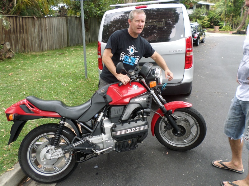

Jez is trying to resolve a rough running issue.
Might have been a major air leak. Might not.
Compression test showed 2 and 3 to be low and 1 and 4 about the same (good).
Not sure if that means rough running or not when cold.
But in the end he gave us scones and we talked more crap. I think that is an achievement.
And I took Mr Klompy on a lovely little windy road known only to locals.
I had fun. He did not expect it so had a bit less fun. I had fun waiting for him at the other end. Only about 2km long.
Roland Ave
Anyhow as Rossko said we had good compression pressure on 1st and 4th but 2 and 3 were way low (95psi) but no change when wet....but previously there was no excessive oil usage or clouds of smoke ( any more than usual )...so I reckon just ride her.

hmm valves ??? or a bridge in the head gasket seem to be the first thoughts
might be an idea to check clearances ?
but certainly because 2 AND 3 being on alternate firing cycles would make it appear rough
you did have "wot" on all tests ?

Yeah Charlie, these question an' more to be investigated next. Well valve clearances anyway.
I've just got a new old set of injectors and have cleaned the TBs so all that goes back this weekend and see how it runs (hope it runs).
What's wot? My mechanical knowlefge is further behind in the race than Rossko's technical lingo expertise. And a head gasket bridge, is that like a breach?
Anyhoo, I only just noticed this thread in the "rides" sub heading, I'll try and keep all technical advancements in the thread titled "Getting this K running right!"
Many thanks to Klompy and Rosskow for coming out (no not the closet) and helping me (they talk and point very well and informatively).
It helps the momentum of one's own progress if only by the jealousy produced by seeing and hearing a couple of very clean K100 pull up outside your house.

wot - wide open throttle ....yes breach between cylinders in the head gasket
Just to chime in here Charlie, the TBs were not on the bike.
Air- hole- cylinder. Nothing in between. So that is a big yes to WOT
