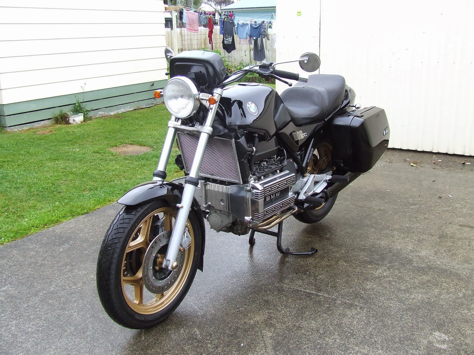

AT LAST IT IS DONE.
ABS REMOVED

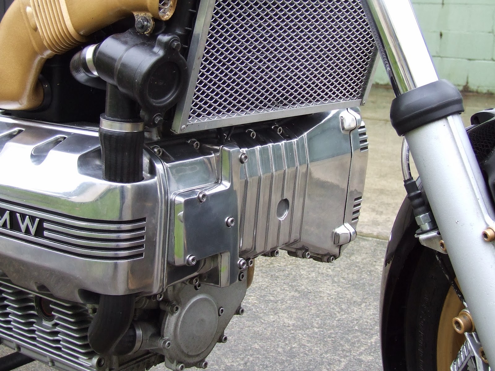

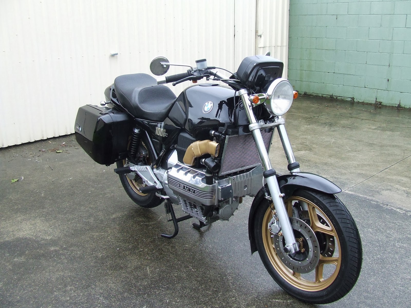

FINAL SET OF PICS (cloudy day) :
SO, ON FEB 13 2013 WE STARTED OUT WITH THIS (uggg)
'89 K100LT >>> K100 CUSTOM CONVERSION - Page 4 249262861
THEN WE WENT TO THIS:
'89 K100LT >>> K100 CUSTOM CONVERSION - Page 4 130227-1502
AND NOW, 9 MONTHS AND MANY HUNDREDS OF HOURS AND DOLLARS LATER WE HAVE THIS:
'89 K100LT >>> K100 CUSTOM CONVERSION - Page 4 DSCF2734
'89 K100LT >>> K100 CUSTOM CONVERSION - Page 4 DSCF2735
'89 K100LT >>> K100 CUSTOM CONVERSION - Page 4 DSCF2736
'89 K100LT >>> K100 CUSTOM CONVERSION - Page 4 DSCF2737
'89 K100LT >>> K100 CUSTOM CONVERSION - Page 4 DSCF2738
'89 K100LT >>> K100 CUSTOM CONVERSION - Page 4 DSCF2740
'89 K100LT >>> K100 CUSTOM CONVERSION - Page 4 DSCF2741
'89 K100LT >>> K100 CUSTOM CONVERSION - Page 4 DSCF2743
'89 K100LT >>> K100 CUSTOM CONVERSION - Page 4 DSCF2744
'89 K100LT >>> K100 CUSTOM CONVERSION - Page 4 DSCF2746
'89 K100LT >>> K100 CUSTOM CONVERSION - Page 4 DSCF2747
'89 K100LT >>> K100 CUSTOM CONVERSION - Page 4 DSCF2748
'89 K100LT >>> K100 CUSTOM CONVERSION - Page 4 DSCF2749
'89 K100LT >>> K100 CUSTOM CONVERSION - Page 4 DSCF2742
THANKS TO ALL FOR YOUR SUPPORT AND ASSISTANCE ON THIS CONVERSION AND THANKS FOR THE MANY POSTS COMMENTS AND PM'S. THIS FORUM IS A FANTASTIC RESOURCE FOR K LOVERS
SEE YAS IN THE WIND AND ON HERE :-))

Great work, You've got to be pleased with that , it's a real credit to you .
philmc
philmc
Hi Keith .Very NICE.
 Phil
MikeP
MikeP
Well done. '89 K100LT >>> K100 CUSTOM CONVERSION - Page 4 112350
1992 K1
1993 K1100R (used to be an LT)
stunning job keith ....!
Finally the photos and well worth the wait.
Excellent job and great attention to detail.
Sling it on a boat and bring it over the the west island so we can kick the tyres and tell you in person what a good job you did.
Hope you didn't ride it after the photo shoot?
Looks a bit wet out there.
Very nice!
I like the gloss finish on the panniers.
Well done Keith. My only reservation is the radiator guard. It looks very square compared to the rest.
There is a mob here called radguard who make radiator guards for all manner of cycles. I just fitted one to my son's F800R. Maybe ask them what they can do or find a similar mob local and ask them. They are not expensive, under AU$100 for the F800R.
http://www.radguard.com.au/

RobinW wrote:Well done Keith. My only reservation is the radiator guard. It looks very square compared to the rest.
Thanks for that. did what I could with it but no one local here wants to knpw about such things. will look in to it
