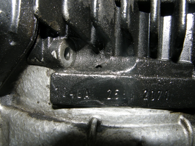

Well, just as things are running smoothly on the RT, for some reason I was on my hands and knees checking the engine number and spotted this.
Turn your computer to the right, this is on the right hand side near the junction of gear box and crankcase.
My simple question is WTF? is going on. Anyone seen this before. Needless to say, my slight oil loss my have just been solved. How the hell do I fix this? chewing gum, gasket goo?
Thanks in expectation.
Suzuki V Strom 650DL 2011. Gasp, chain driven.

What makes you think the hole is mysterious?
I can see it plain as day. It is a hole. Nothing mysterious about it.

3Back to top Go down    Re: Mysterious Hole in Crankcase on Mon Mar 04, 2013 6:32 am
I will have a look on the engines I have here and get back but I have a feeling that it is ok and quite possibly just a bolt hole that has been drilled just a touch too far before it was tapped for the thread. I wouldn't be overly concerned about it.

4Back to top Go down    Re: Mysterious Hole in Crankcase on Mon Mar 04, 2013 6:42 am
looks like a sump cover bolt lost ......shouldnt cause a big issue ,,unless you have a lot of oil around that junction as the sealant would probably keep it free from leaks ,,,,,
but maybe would be wise to check the etk for the correct size-length to replace it ????

5Back to top Go down    Re: Mysterious Hole in Crankcase on Mon Mar 04, 2013 7:09 am
Charlie...we're looking at the tiny hole to the right of the bolt hole... Shocked

6Back to top Go down    Re: Mysterious Hole in Crankcase on Mon Mar 04, 2013 7:14 am
fill it up with metalset...or DEVCON...its just a minor thing ....I do remember having an electrical problem once when a conrod took out my alternator....this is not a problem in comparison.What a Face

9Back to top Go down    Re: Mysterious Hole in Crankcase on Mon Mar 04, 2013 7:56 am
k blakey i get what you mean
looks like a slight bubble in the casting to me ......sounds like an acetone to clean it up and a bit of liquid metal to make it apear to be ...erm ...solid ...
but the missing bolt above is of some concern
heres a blurry pic of how mine is ......its dark outside ...and wet
looks about 6mm x 20 - 25mm to me .....if this was missing there could be a little weep out of there ...maybe ?
but looks as though you crank cover seal rubbers has started to loose the seal bob
maybe replace that seal ./....and the rubbers for the retaining bolts ( they loose presure over the years ) or run some "good sealant " over the crankcase seal ...wait for it to go off then put the crank cover back on ???
just some thoughts after my leak events recently

10Back to top Go down    Re: Mysterious Hole in Crankcase on Mon Mar 04, 2013 8:13 am
looks like an allen/hex screw ...wack one in see if it takes up..could be that hole was caused through rough handling removing or fitting that bolt.

11Back to top Go down    Mysterious Hole in Crankcase on Mon Mar 04, 2013 5:05 pm
Tks everyone, there is a small amount of oil there, maybe Charlie is right, coming from the crankcase seal. Just another job.
To be honest I thought that bolt hole was where the lower fairing bolt was located, I think I have something that will go in there.

24Back to top Go down    I agree with Rick G on Fri Mar 08, 2013 11:22 pm
ibjman
I'm sure this is not an issue.....it was simply one of the bolt holes from the rear housing adaptor that was drilled a shade to far at original mfg. see my pics. the screwdriver shows that mine was also drilled almost through in that area. since the other side of this "hole" is into the rear threaded bolt hole area, it does no harm (unless you are worried about road salts & water getting in through that hole and rusting up the rear facing bolt threads. In that case, just block it with a dab of some sealer. No worries, nothing will be leaking outward from that hole.
Here's a pic of an old spare I have (1985 K100RT). You can have it for free if you want to pay to ship it from the USA.

30Back to top Go down    Mysterious Hole in Crankcase on Sat Mar 09, 2013 5:36 pm
Thanks ibjman, that puts me at ease. I'll pass on the engine, I've got one in a shed doing nothing as well.
