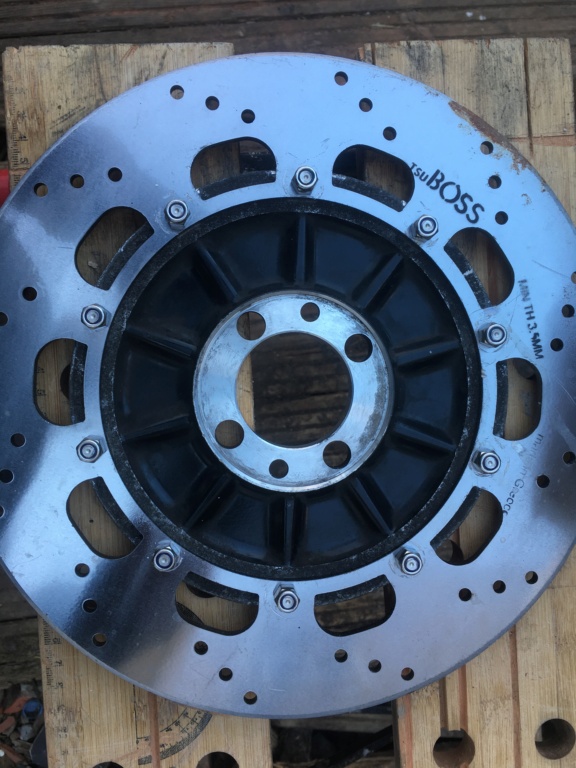

I’ve finally undertaken my brake disc changeover as per the directions posted by Holister. I am using A4 grade dome head Allen bolts and my lock nuts.... just wondering what torque I should nip em up to? Any advice welcomed!

There it is! So the bolts were a slight pita, but eventually came out with some vigorous persuading with a drift and hammer.
New disc looks the part....hopefully will be noticeable under braking conditions, although to be fair, I don’t use them much...apart from slow riding....so hopefully the “pulsing” will go!

BooG wrote:I’ve finally undertaken my brake disc changeover as per the directions posted by Holister. I am using A4 grade dome head Allen bolts and my lock nuts.... just wondering what torque I should nip em up to? Any advice welcomed!
Looking good, hope it works well.
Sorry to be casting doubt, but I notice your "locknuts" appear to be "nylock". I wonder if they are correct in this application given that they may get very hot in extended braking.. maybe enough to melt the plastic inserts.
Conventional nuts may torque better with a longer threaded section. Maybe an engineer could give an opinion.

check for runout on the disk carrier , just a heads up
good luck
good luck

Nylon has a melting point well north of 200C. It's pretty unlikely that the nylon inserts are going to melt and let the discs loosen up.

Thanks for the replies. Yes, the runout could be an issue regarding the nylock nuts. I’ll post back when I’ve attempted fitting the disc.
I wonder what my options are if the nuts do interfere with anything.?? I wonder, could I cut the bolts back a bit and ( with the help of my persuading tool, encourage them to behave like rivits ?!?

According to the manufacturer U.S.Fasteners, their common locknuts have nylon inserts made from Zytel 101 which has a melting point ≤121ºC; their special order insert's melting point is ≤177ºC.Point-Seven-five wrote:Nylon has a melting point well north of 200C.

You can always source out some top lock nuts. I know they are available in a lower profile as well. They use a small section of distorted threads to lock them in place thus eliminating the nylon insert and having a lower profile.
Might do the trick.

If you use button-head allen bolts, you can put them button-head side out. Looks a lot prettier and there's no clearance problems.

Laitch, I suspect that the U.S. Fastener data sheet inadvertently copied the temperature from the DuPont technical data incorrectly. DuPont lists the Vicat softening temperature as 240C(465F) and the deflection temperature as 200C(390F). Melt temperature is 263C(505F). Nylon/Zytel has a rapid transition from solid to melt. As a result, it doesn't soften and maintains its mechanical properties at elevated temperatures until rapidly changing to a plastic state. I think the U.S. Fastener guy misread the C as an F when they copied the data.
If Zytel melted at 121C(250F), it wouldn't be one of the most used polymers in automotive under hood applications. As a point of reference, the polyethylene used in milk bottles melts at a higher temperature(>300F).
I doubt that the wheel hubs would get hot enough to melt it, and if they did, the larger problem would be rotor warpage.

Have placed the nuts the other way around now, (rotor-side). I’ll post back when I’ve attempted fitting again.

Well....that worked then!
Isn’t it “Occam’s Razor” which states that the simplest explanation is usually the best?
So anyone else doing this: face the dome heads towards the hub, and the nuts facing the exhaust side. Job done!
Haven’t been out for a test run yet but I will shortly so watch this space!
