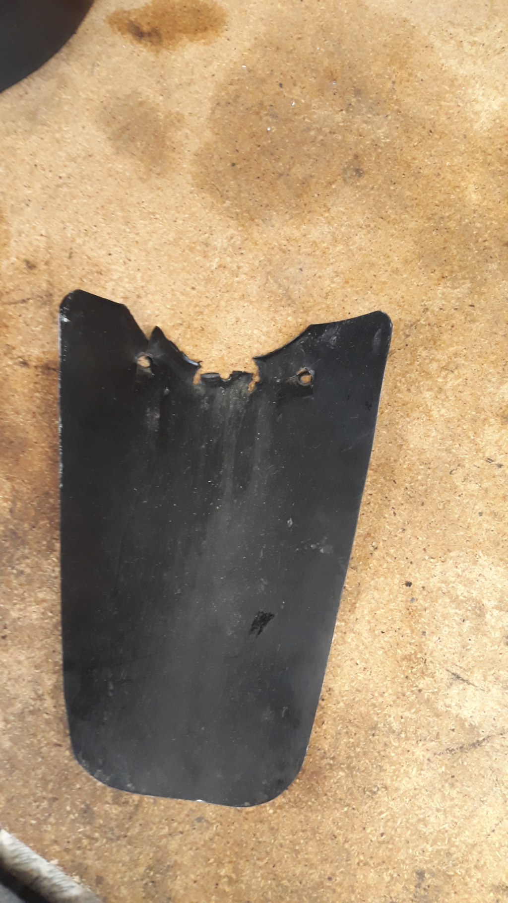

After 7 years of faithful service a recent ride into NSW saw my bucket flaps demise.  18 K of ruts and a mixture of large gravel (small rocks) and fine gravel ridges battered it into submission. It did however do its job with no damage to the belly pan. Just after the torture test it bent up and there was a significant split in it. So I decided to upgrade it to a $4.50 Bunnings bucket and they did however still have the cheaper bucket but now priced at 99c. The difference is the old bucket is .75 mm thick the new bucket 1.85 mm thick. I used the old one as a pattern and cut it out with shears and you still get 5 flaps per bucket and a shallow bowl.
Regards Martin.New improved Bucket Flap $4.50 New_bu10
New improved Bucket Flap $4.50 New_bu11New improved Bucket Flap $4.50 New_bu12
New improved Bucket Flap $4.50 New_bu13
