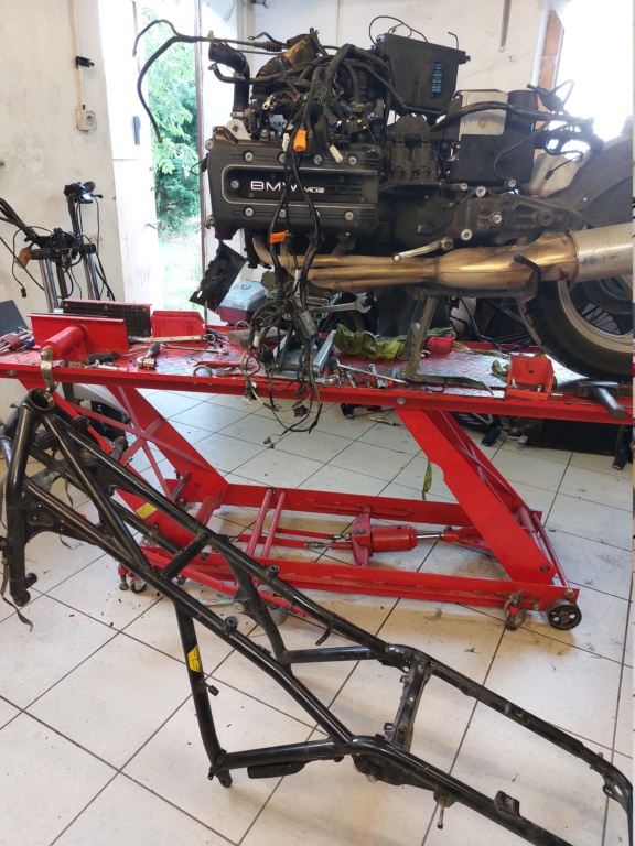

A friend, former mechanic for police vehicles, lent me a specific BMW tool for K75/100/1100/1200:
Jack for K engine 20230812
Jack for K engine 20230813
The plate bolts on the engine case at the points the crash bars are fitted.
Then it's linked by a spline shaft, mounted on a ball joint, to the jack.
The jack itself sits on a rolling chassis, ideal to split the engine from the box to check the clutch. It make things easier when you have to put everything in line when fitting the gearbox to the engine.
That will help me a lot for this month job: frame and clutch change on my K1100LT
Jack for K engine 20230814
The clutch is dead. And the frame...well, I had this bike for years, bought it in Switzerland but never really registered it here as I already had a K11 registered in my name, but dismantled.
Normally, I was not supposed to hammer new numbers on the frame.
But I've traveled all Europe with this bike for 7 years and nobody never asked me the papers nor checked the frame plate.
So, changing the clutch was a good opportunity to change the frame by the same time.
But what a job!
