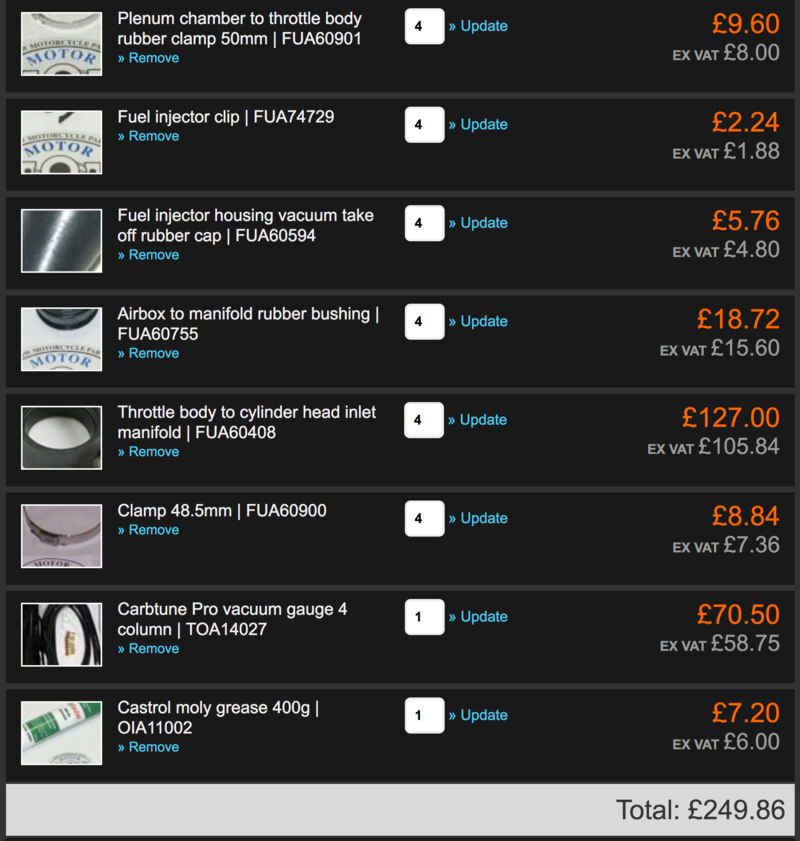

3. Here is the parts list i'm preparing to order. Do i miss anything? Its crucial because ordering from Motorworks UK takes to reach my Island more than 2 weeks. I m thinking that it would be wise to replace all 4 inlets, lower and upper and clips.

1. You don't need Oetiker clamps. You can use worm drives (jubilee clips). Just be careful not to foul the throttle quadrant which will stop the throttle from closing. A lot of us have worm drives down there now.
2. No... but the repair should last for quite a few years / kms.
3. A couple of questions:
  Why do you need the injector clips? Unless yours are really rusty, they're reusable.
  I'd get a couple of sets of the rubber vacuum caps. They do have a habit of disappearing when you're not looking Very Happy
  Throttle body inlet manifold - I stuck mine down with Threebond as a 'belt-and-braces' safety measure.
4. Don't you need the crankcase to airbox breather pipe as well (ENA60480)? This is another item that I'd consider getting two of; regretably they don't seem to last very long.
5. Fuel lines: your local autoshop will be able to help there. 8mm x 13mm lines are okay.
Also, check the vacuum hose to pressure regulator pipe (FUA45323).
Can't think of anything else... Anyone?

Dai i m getting the injector clips to replace the old ones. Its a minor cost so i try to gather any available part especially if cheap.
So i m droping the oetiker special clamps and heding to standard 48mm worm style from a local market.
And yes i will add the z-shaped breather hose as the vac to pressure reg hose.
Thank you!
