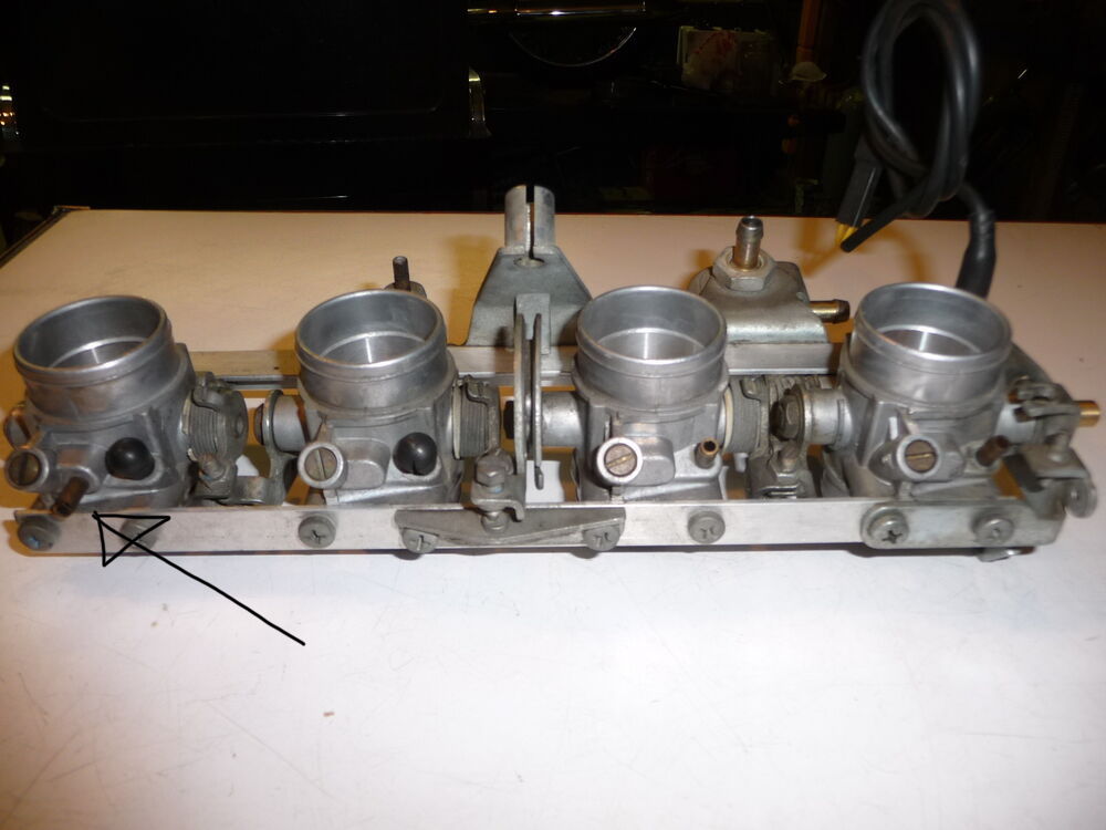

What is this? Tue Jun 04, 2019 12:25 am
Heresy23
So do you think this could be adding to the terribly low idle issue I’m having ? Though the vacuum cap replacement helped....and I capped off the stub in question....but I still feel like I have a vacuum leak ,or somethings not right ...when I rev my throttle it’s a bit slow at returning to 0....I’m gonna buy a hose and connect this either way ...@chris846 wrote:That's quite an early K. The hose in question, and the doohickey on the end of it were used to send intake vacuum information to the ECU. This apparently had so little effect/use that the Gods of K cast it aside. You can safely cast it aside too (and blank the stub off) or you can invest in some 4mm hose and get it, erm, working again...
