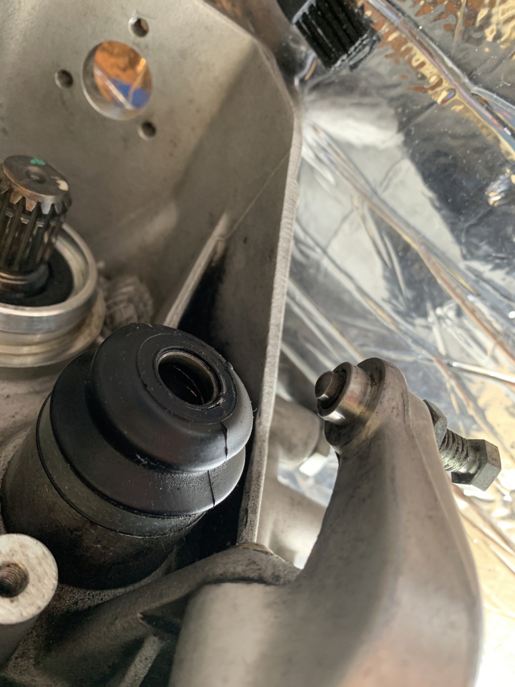

bmwk100rs wrote:I finally had time to remove the transmission. It's obvious that the rear main seal is leaking.
How have you verified that it's the rear main seal leaking rather than the output shaft o-ring leaking?

Laitch wrote:How have you verified that it's the rear main seal leaking rather than the output shaft o-ring leaking?
Laitch, good point. I'll remove the nut tomorrow to find out. Hopefully, the o-ring is the one leaking since it will be easier to replace beside cheaper. Cheers!

5Back to top Go down   Rear Main Seal Leaking Empty Re: Rear Main Seal Leaking Tue Jul 06, 2021 5:37 am
If you are in there, replace the rear main seal, the O ring, gearbox seal [no need to open the gearbox, its replaced from outside]. Clutch friction plate is cheap too, buy Sachs as they make them OEM.
Its a bit of a false economy to leave original stuff in there due to bike age. Been in on my 84 K100 RT at 78,000 miles [bought at 36,000 miles] and rear main seal failed at about 70,000 miles, replaced at 78,000 as I had some trips planned. By that stage it had just reached the clutch plates.
A lot of other little items, O ring, clutch pivot arm bearings [change them to bushes and grease nipples], drive shaft boot, clutch pushrod boot,

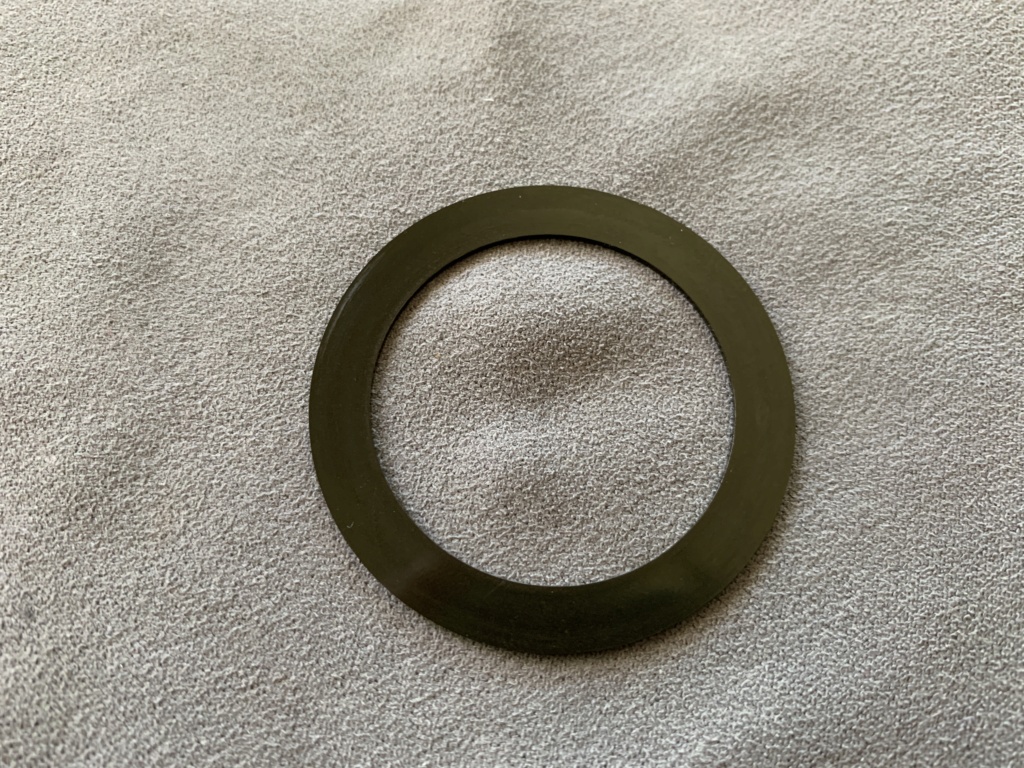

12Back to top Go down   Rear Main Seal Leaking Empty Re: Rear Main Seal Leaking Wed Jul 07, 2021 7:45 am
@92KK 84WW Olaf wrote:Did you order the O ring and other parts needed?
You have to take off the O ring to get at it. Its not reusable.
These are from Motorworks. Also the clutch bolts are single use stretch bolts and are not part of the clutch plate kit..
Output shaft to clutch carrier O-ring | ENA60456
Fits K1 (09/1988 - 08/1993), K100 (09/1983 - 08/1987), K100 (09/1987 -... Show All...

13Back to top Go down   Rear Main Seal Leaking Empty Re: Rear Main Seal Leaking Fri Jul 09, 2021 11:50 pm

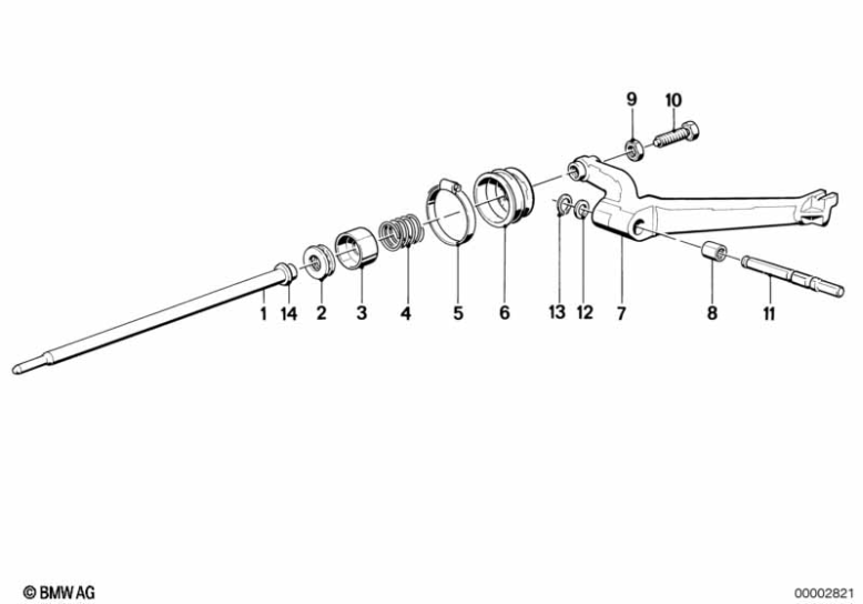

Is the tool below needed to remove the nut? Others seem to be able to remove itwithout it.
Rear Main Seal Leaking Img_0913
14Back to top Go down   Rear Main Seal Leaking Empty Re: Rear Main Seal Leaking Sat Jul 10, 2021 12:41 am
bmwk100rs wrote:Is the tool below needed to remove the nut? Others seem to be able to remove itwithout it.
What are the others doing to it that fails to convince you that they're actually removing it without it? Laughing
Here is additional information to confound you from the Duckian Brick Research and Development Laboratory located at an undisclosed location somewhere in the Pacific Northwest, maybe. Scroll through it.

bmwk100rs
bmwk100rs
Laitch wrote:What are the others doing to it that fails to convince you that they're actually removing it without it?
The video here: https://youtu.be/3heap0adhXM?t=35
Thanks for the link to Drake Smith's page.
16Back to top Go down   Rear Main Seal Leaking Empty Re: Rear Main Seal Leaking Sat Jul 10, 2021 3:21 pm
That video shows its being removed. Pick one of the methods you've run across and remove it.  cheers
Rear Main Seal Leaking Usa-lo10

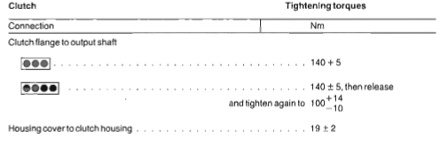

17Back to top Go down   Rear Main Seal Leaking Empty Clutch Stop Disc Tue Jul 13, 2021 7:23 pm
bmwk100rs
bmwk100rs
I ordered several of the parts you guys suggested here. However, I just realized that I didn't order the Clutch Stop Disc (11 21 1 460 873). Is it necessary to replace it when it still looks in perfect condition (1mm without cracks or scratch marks)?

18Back to top Go down   Rear Main Seal Leaking Empty Re: Rear Main Seal Leaking Tue Jul 13, 2021 7:41 pm
No its reusable

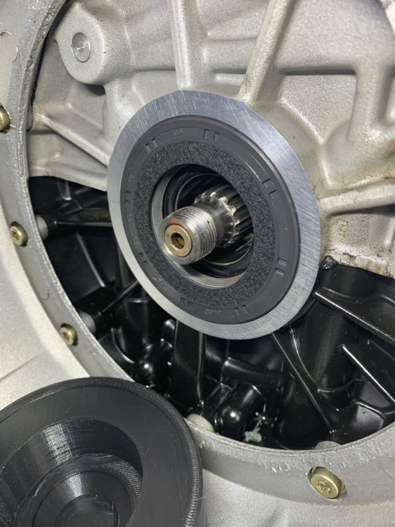

The seal came out easily without any fight. The new should arrive tomorrow. However, I don't have the recommended mandrel (83300401441) to drive it in. Max BMW doesn't have it in stock and it will take ~4 weeks to ship it from Germany. The wood version made by Kenneth Lively is also out of stock, but he is might make more in 2 weeks. Does anyone know where I can purchase this tool in the U.S.?

21Back to top Go down   Rear Main Seal Leaking Empty Re: Rear Main Seal Leaking Wed Jul 14, 2021 1:09 am
Yes  you can tap them in slowly and softly with a bit of wood and rubber hammer
Make sure you sand the back of the clutch basket were the seal cut it new grove

22Back to top Go down   Rear Main Seal Leaking Empty Re: Rear Main Seal Leaking Wed Jul 14, 2021 2:23 am
bmwk100rs
bmwk100rs
Matthew-Brisbane wrote:Yes  you can tap them in slowly and softly with a bit of wood and rubber hammer
According to the BMW Service Bulletin below, tapping them with a bit of wood or rubber hammer might not install them correctly.
Regarding sand the back of the clutch basket were the seal cut it new grove, do you mean sand the area where the arrows below are pointing?
Rear Main Seal Leaking Output10
Rear Main Seal Leaking Img_0918
23Back to top Go down   Rear Main Seal Leaking Empty Re: Rear Main Seal Leaking Wed Jul 14, 2021 2:34 am
No
If you have a look at the clutch basket shaft you will see some  very fine wear mark that  the previous seal  would have cut in

26Back to top Go down   Rear Main Seal Leaking Empty Re: Rear Main Seal Leaking Wed Jul 14, 2021 8:09 am
I made a seal installation tool out of a chunk of 1x4 pine and a piece of cardboard from a cereal box.
Trace the seal on the cardboard and cut a hole just a bit larger than the seal.
Glue the cardboard with the hole on to the piece of pine wood.
Start the seal into the engine and then with the block tap it gently into place. When the cardboard on the pine block touches the face of the engine the seal will be standing proud by the required amount.
27Back to top Go down   Rear Main Seal Leaking Empty Re: Rear Main Seal Leaking Wed Jul 14, 2021 10:23 am
bmwk100rs wrote:
Matthew-Brisbane wrote:very fine wear mark that  the previous seal would have cut in
Mine just has a fine line around. I'll try to clean any residue from the preview seal instead of sand it.  Thanks for pointing this out though.
You don't need to use sandpaper on this stuff. Use a fine Scotchbrite-style abrasive pad to polish it, if that is necessary.
You also need to determine if you'll be using a Teflon seal. Teflon seals don't get oil-soaked like earlier seals and their openings are gently widened so they fit over the shaft. They will contract once installed.

bmwk100rs
bmwk100rs
I'm ready to refit the new teflon output shaft seal. The Haynes book says, "apply a thin smear of great grease to the housing, the seal outer edge, and its sealing lips".
Questions:
1) What kind of grease?  Staburags NBU 30 PTM?
2) Where are the sealing lips?
3) Is the black Teflon seal better than the orignal brown version?
TIA!
Rear Main Seal Leaking Img_0922
32Back to top Go down   Rear Main Seal Leaking Empty Re: Rear Main Seal Leaking Sun Jul 18, 2021 11:11 pm
The sealing lip is the inner part that runs on the shaft, it's lighter in colour. NEVER use grease on a seal when it is going to seal oil and vise versa, grease and oil do not mix and it can very easily burn the lip of the seal and it will fail again. Put a fine smear of oil on the seal and tap it in using a block of soft wood and a small mallet making sure it is going in evenly all the way round. Haynes do not make very good mechanics I see many bits of bad advice in their books.
33Back to top Go down   Rear Main Seal Leaking Empty Re: Rear Main Seal Leaking Mon Jul 19, 2021 12:53 am
bmwk100rs
bmwk100rs
RicK G wrote:NEVER use grease on a seal when it is going to seal oil and vise versa, grease and oil do not mix and it can very easily burn the lip of the seal and it will fail again. Put a fine smear of oil on the seal and tap it in using a block of soft wood and a small mallet making sure it is going in evenly all the way round.
Thanks RicK G!  I used oil and the new seal is now installed.

bmwk100rs
bmwk100rs
Laitch wrote:My answer is yes, yes, but only if you're a literalist.
Thanks Laitch. BTW, I'm not able to pull the pushrod out of the transmission. Does it need to be released from behind by detaching it from the thrust piston and bearing?  Both ends seem to be okay (including the rubber boot -- no dry/leaks/cracks), should I just apply a little bit of grease to it and leave everything else alone?
Rear Main Seal Leaking Img_0928
Rear Main Seal Leaking Img_0929
Rear Main Seal Leaking B0000510
37Back to top Go down   Rear Main Seal Leaking Empty Re: Rear Main Seal Leaking Tue Jul 27, 2021 10:37 am
bmwK100rs wrote: Does it need to be released from behind by detaching it from the thrust piston and bearing?
You don't detach it from the piston/bearing assembly; you detach them from it, as Haynes indicates, and draw it out rearward. It isn't a hairy and complicated process, if you want to take a look and the components.
The moto has 53K miles on it which isn't much on one these clutches, unless the previous owner neglected to keep it adjusted to spec and it was slipping without notice for thousands of miles—a distinct possibility. While you were in there, did you check the clutch disc for wear?
Which lubricant did you apply to the transmission input shaft splines?
What you should do depends upon your confidence, your tolerance of uncertainty and your deference to the doctrine of anicca. Smile

38Back to top Go down   Rear Main Seal Leaking Empty Re: Rear Main Seal Leaking Tue Jul 27, 2021 3:50 pm
bmwk100rs
bmwk100rs
Laitch wrote:While you were in there, did you check the clutch disc for wear?
Thanks again for the clarifications.
Although the orignal clutch is still within spec, I'm installing a brand new one that I already had.
Regarding lubricant, I'll apply Staburags NBU 30 PTM.

50Back to top Go down   Rear Main Seal Leaking Empty Re: Rear Main Seal Leaking Mon Aug 02, 2021 11:08 pm
bmwk100rs wrote:Everywhere, the initial torque recommended is 140 N-m, but is the final one 60 N-m or 90 N-m?
Just to elaborate on daveyson's explanation—because I have expended considerable effort spacing commas correctly—sometimes submission to authority is the way to go. Stick with torque values for simplicity.
Here's the torque table from the Clutch chapter of BMW's K75/100 2V service manual onsite. What this means is after the initial tightening and release, you have a dizzying array of Newton meter choices—90, 91, 92, 93, 94, 95, 96, 97, 98, 99, 100, 101, 102, 103, 104, 105, 106, 107, 108, 109, 110, 111, 112, 113, or 114. If you have a lucky number among that array, now's the time to use it. Anything below 90—including 60—is not part of the fun.
I hope I understand what you're after; I seem to be encountering comprehension obstacles tonight.
