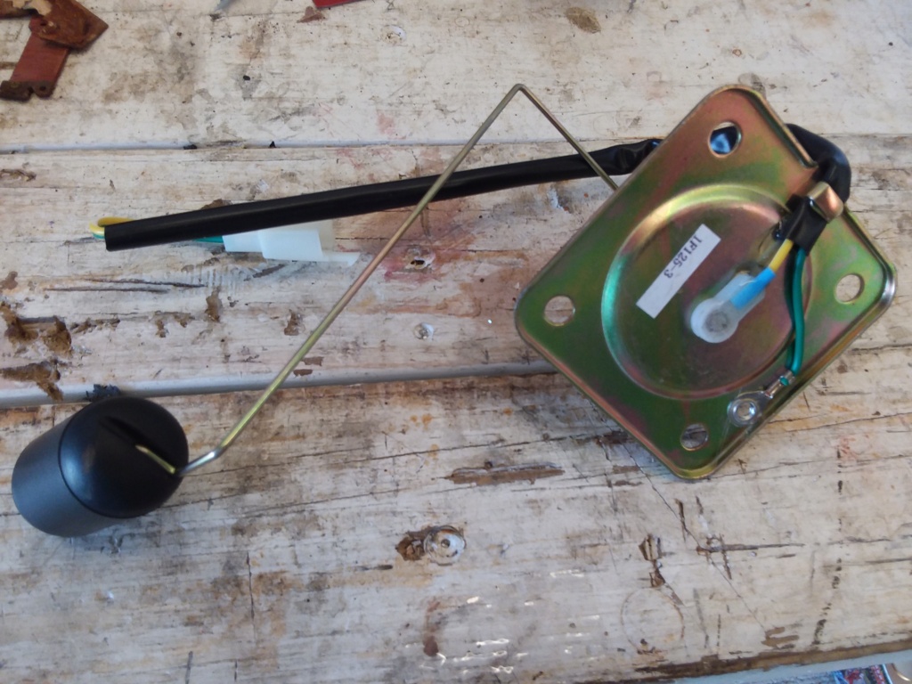

Disclaimer: This will not provide you with a working fuel sending unit. What it will do is allow you to cheaply replace the rusty fuel sending unit with one that will allow power to get to the fuel pump.
Rather than spending $325 on a new unit this fix will cost about 50 bucks.
What you need to buy:
  • Fuel level float ring for $5   #62 16 1 459 608 from Euro Motoelectrics
  • Fuel Systems  in-tank wiring  $20 from Euro Motoelectrics
  • Motorcycle Scooter Fuel Tank Level Gauge Oil Meter Sender Sensor for WY-125 $13.29 on eBay
The new unit looks like this:A $15 Fuel Level Sender (sort of) 20230111

I carefully broke the new fuel level potentiometer off the base. When you do this you want to leave a tit of metal protruding up from the base. (I got lucky for mine to break that way.)
Then you are ready to solder two new wires to the inside base.
I drilled a small hole into the tit of metal to make soldering easier.
I even used the existing solder left behind on the center post.
Next, I attached the two rings that fit the post on the fuel pump (from old unit).
You can then either attach the connector from an old unit onto  the outside lead , or as I have done used a new two wire connector on both the bike and this unit, as the oem connectors are know problems.
A $15 Fuel Level Sender (sort of) 20230112
A $15 Fuel Level Sender (sort of) 20230113
brianpen
brianpen
Finally, I used the new float ring gasket on the new unit and installed it with the four original bolts. The  beauty of this unit is that the bolt holes line up perfectly.
I apologize for the disjointed posts. Couldn't figure out how to add text below a photo. Anyhow I hope this saves someone who is faced with a fuel sending unit that is rusted beyond repair.
