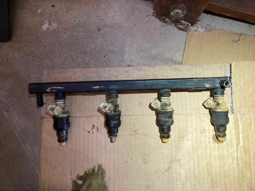

I used the wooden lever under the fuel rail method as described on the forum and almost got all 4 injectors out - except for the injector tip on No3. Photos attached.
Any tips on how to remove an injector tip?
