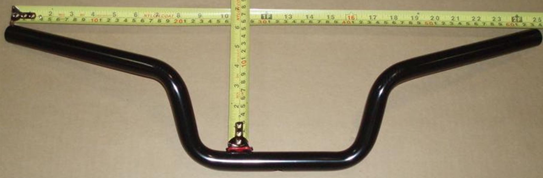

K75S & K100RS Bars - Clutch cable 32732324955 - 1510mm
Clutch cable K100rs.k75s.bars.tape.measure
K75 Std, K75C, K100 Std bars - Clutch cable 32732324955 - 1510mm (same as above)
Clutch cable K75C.Handlebars.Tape.Measure
"High" bars - K75RT, K100RT, K100LT - clutch cable - 32732324960 or 32731450215 - 1625mm
Clutch cable K100RT.Handlebars

Thanks for the replies! I definitely Have low bars. Am ordering new today.
