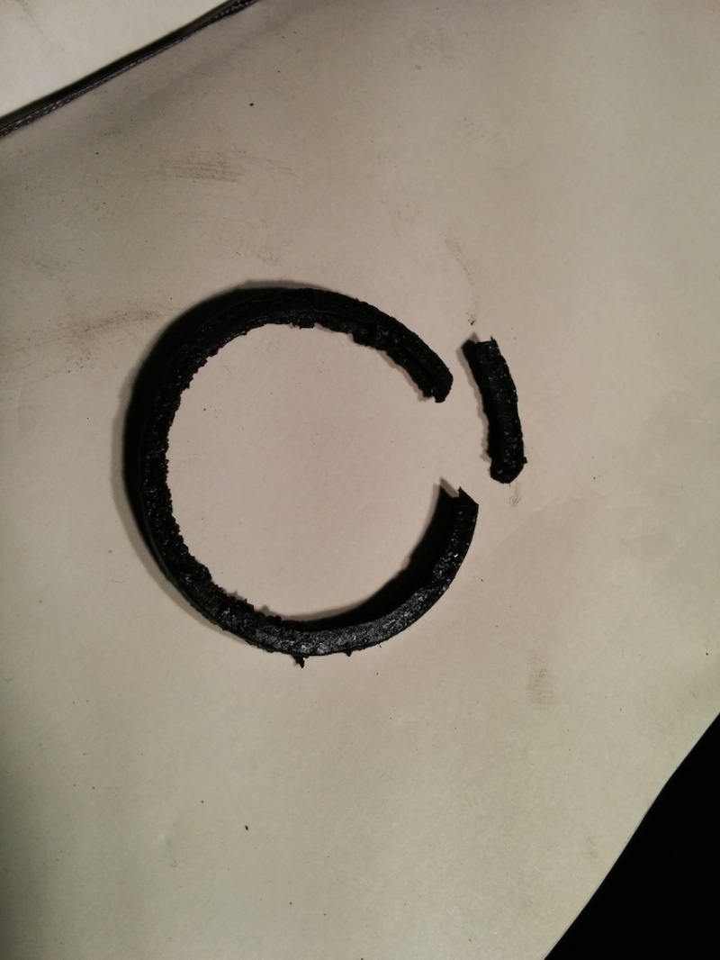

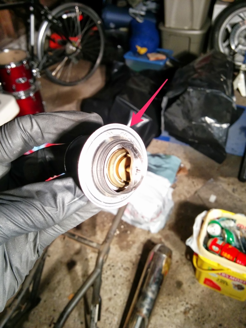

I pulled my thermostat to check and replace the gaskets and found that the gasket that seals the outer edge of the thermostat to the inner wall of the housing was badly deteriorated and, in fact, broken in one section. I pulled this piece off, photographed it, and set it aside, thinking it would be easy to find a replacement.
Thermostat gasket, not o-ring Img_2012
Thermostat gasket, not o-ring Img_2013
Realoem.com makes no mention of this part anywhere in the diagrams, and information on Google is sparse.  Some people were discussing somewhere that the thermostat itself can be replaced with one from a '94 Toyota Corolla though the overall length goes from something like 30mm to 35mm.  Diameter is the same.  A quick trip to my local Autozone got me a gasket for the Corolla thermostat (#35292) which fits the K100 thermostat like a charm.  The problem is that it is slightly thicker in all dimensions such that it will not seat properly inside the housing.
Does anyone know where a suitable replacement can be found?  Do I need to just cut this one down or compress it somehow?
Thanks!

there are 3 versions of the gasket that I have found , all varying in thickness and width ...still to try the thinnest wall version, as you say the overall thickness difference between the thermostat and outer wall of the housing is quite small ,,,maybe 2.5- 3.00mm overall
I would guess a slight cut in the external diameter would not overly affect the operation ,,,what could be important is the thickness (width ) of the seal to allow for good location of the mechanism behind the retention fitting of the cover without too much pressure and maintain a good seal around the front of the housing cover.

Hi there
During last year's bike maintenance, was time to replace the cooling mixture and check the system components, everything was ok but when reinstalling the thermostat found that the internal gasket (not the oring) had swelled and will not fit. The diameter had increased about 3mm, perhaps due to the cooling mixture components.
Searching on google found that by heating the rubber it would shrink, try with a heat gun and boiling water with no succes.
Finally baked it in the convection oven at 350ºF by around 30minutes (checking it every 5 not to burn it) and came out at original size without loosing flexibility nor distorted.
Hope this helps
Best regards
JA

@japuentes
That sounds like a sound solution in your case, but what I believe may have happened is that baking the gasket evaporated whatever solution worked its way into the rubber that caused it to swell.  The gasket that I purchased from Autozone is already at this increased size, and I'm not sure that baking it would reduce the size.  I can't imagine it would hurt though!

@tgolden
It is my understanding that this part you're referencing is the o-ring that seals the housing cover, not the gasket that seals the edge of the thermostat.  The first image I posted above points to the part I'm referring to.

I don't see that there are two seals in the area of the thermostat. I checked RealOEM, a parts microfiche and the bound parts book.
It's interesting that there are no pictures of this "second" seal.
Did you have two seals when you disassembled it?
Call a BMW dealership and ask the parts guy about it.

I see a picture of a seal that appears to mount on the thermostat's large disc or that it appears the large disc is fitted into an inside slot in this seal in the Haynes manual.
You may be able to make the one you got from an auto parts store fit if you adjust the dimensions with some abrasive paper. Perhaps you've got to buy a new thermostat to get that seal.
If you go back to the auto parts store, they may be able to find you one that fits better.
Apparently, this isn't an individual part in the BMW system. I think it should be.

I agree that it should be as well!
If you check this post, robmack's first image shows the o-ring on the housing cover and his second image shows the gasket that surrounds the thermostat itself.
Any place I've seen an OEM or aftermarket thermostat does not have this gasket.

I'd make the gasket for the Corolla fit. I'd also replace the o-ring for the cap.
Call a BMW parts store and ask for a solution.

Motorworks lists two seals for the thermostat. A coolant thermostat u-seal and coolant thermostat cover o-ring.
https://www.motorworks.co.uk/vlive/Shop/Parts.php?T=5&NU=15&M=40&Ct=GA&SbCt=BA_15_40_GA_70
Order it from Motorworks.

Euro Port Parts list a thermostat u-seal that may fit.
Engine Coolant Thermostat Seal Part Number: 225 33099 071 Manufacturer: REINZ
The price is $1.06 which is better than Motorworks. It will be USA shipping as well.
http://www.europortparts.com/
Enter the part number in the website part # search box.
The dimensions aren't indicated, but I suspect it will fit. Contact them and inquire.

Nice find!  That looks like it's the one  cheers
Ordering ASAP.

I think BMW part # 17111460718 is the thermostat cap o-ring seal.
The seal that he needs is the thermostat u-seal that's not listed as an individual BMW part.
Motorworks sells this second seal in the UK. See post 13. We'll have to wait and see if the thermostat u-seal that Euro Port Parts sells fits.

diesputnikdie wrote:
tgolden wrote:Euro Port Parts list a thermostat u-seal that may fit.
Ordering ASAP.
I checked the shipping charges and Euro Port Parts wants $11.67 for UPS Ground shipping. Total cost would be $12.73.
Motorworks (UK) wants £13.99 or about $23.32 in US Dollars for delivery to USA for the one they sell that they advertise as a direct fit for the K-bike.
Do a Google search for the 225 33099 071 part number. There are several places that sell it perhaps with reasonable shipping charges. There's a guy on eBay that's selling it for $4.95 w/ free shipping.
Some of the websites selling this thermostat seal list the application as a 1998 Mercedes E300. Check your local parts store to see if they have it under that vehicle listing. It would be better to check the fit before you buy.

tgolden
tgolden
If anybody knows the dimensions for this thermostat u-seal, please post them. The dimensions, preferably in mm, would be helpful to locate a suitable replacement.

diesputnikdie
diesputnikdie
tgolden wrote:...
That's the exact one I ended up getting after seeing the crazy shipping prices from epp.
Fri. Feb. 28 - Thu. Mar. 6 is estimated shipping date.  Will advise when it arrives.

If someone would provide an accurate measurement of the inside diameter of the thermostat port and the diameter of the thermostat disc that mounts the u-seal, I think that the USA tech rep for Victor Reinz could provide the correct part number for a u-seal that would fit. Preferably, these measurements should be in mm and measured with a caliper. The thickness of he seal should be specified also.
1985 K100RS USA Model WB1051300F0042533 - Original Owner
Delivery: 04/85 - Motorradhaus Ebert, Höchberg, Deutschland
36Back to top Go down   Thermostat gasket, not o-ring Empty Re: Thermostat gasket, not o-ring Wed Feb 26, 2014 12:49 pm
Gasket:
2.5 mm thick
48 mm O.D.(49.2 when installed)
37Back to top Go down   Thermostat gasket, not o-ring Empty Re: Thermostat gasket, not o-ring Wed Feb 26, 2014 12:58 pm
tgolden
tgolden
Thanks duck.
Did you measure he gasket or the gasket socket? Measuring a rubber gasket can be problematic.
Do you have a measurement for the thermostat disc diameter?
I think that when trying to source a rubber gasket, it's good to know the dimensions of the space the gasket fills, because there can be difficulty getting the nominal dimensions on a thin flexible rubber gasket.
Regards
38Back to top Go down   Thermostat gasket, not o-ring Empty Re: Thermostat gasket, not o-ring Wed Feb 26, 2014 1:24 pm
Measuring the gasket wasn't problematic at all. It's 48 mm.
The t-stat is 47.7
39Back to top Go down   Thermostat gasket, not o-ring Empty Re: Thermostat gasket, not o-ring Wed Feb 26, 2014 2:47 pm
tgolden
tgolden
Measuring a gasket is problematic in the sense that the measured values sometimes don't match the published nominal dimensions. At least that's been my experience.
So in summary we have:
Thermostat diameter: 47.7mm
Thermostat housing (port) inside diameter:
Thermostat U-seal outer diameter (unmounted): 48mm
Thermostat U-seal inner diameter (unmounted):
Thermostat U-seal outer diameter (mounted): 49.2mm
Thermostat U-seal width (longitudinal):
Thermostat U-seal width (radial):
I'm not sure what direction the 2.5mm thickness indicated.
The mounted diameter of the U-seal likely compresses for a snug fit in the thermostat housing.
I think that if we can fill in the missing dimensions, it will be easier for the Victor Reinz support to suggest a replacement part number.

ok
have got the parts
heres the result
the ttg 47 gasket designed for the corolla at 50mm x 6.5mm is a roundish edge profile rather than a square edge external diameter.
probably to take up the thermostat housing on said corolla .
once fitted over the thermostat is diameter increases slightly (maybe another 1 mm or so )
and whilst you could fight with it and get it in maybe some soap to assist slide it in and down .....
I recon the thickness would be just a little too wide at 6mm resting
I opted for different part
a "ttg 26 " which is actually 47mm external diameter x 4.5mm , but with square edge external
the sides look like they would compress to straight with the front face of the retaining body assembly
when assembled  a little better
the assembly with the ttg26 gasket fitted to the new thermostat .....(slight issue with the central groove of about .5mm being too wide and the slight stretch to fit around the larger 47mm thermostat )
slid down into the housing quite nicely
because of the slight wonkiness of the central groove care had to be taken in negotiating the ports feeding from the radiator core to the housing
so put that side in first
the rest just slid into place and all looked fine with a good seal achieved
the front assembly went on great with some compression of the thermostat gasket felt as it pushed home easily .
tightening felt good
I will look up the application of the ttg26 to see what it is made- compatible with so that others may benefit and ask for the right thing ....the first time ...
and be assured it fits first time
total time for trying this all out ...about 1/2 an hour

tgolden
tgolden
Good information. Are you fitting the replacement thermostat seal to the BMW OEM thermostat or to an aftermarket thermostat?
We should rank the fit for these different thermostat seals based on part number.
I think it's possible to find the OEM seal. It's just going to take a bit more effort. I sent an email to Victor Reinz, but haven't received a response. I didn't send any dimensions, only the BMW thermostat part number. I suspect they may want some dimensions if they can't find the specs on the thermostat.
BMW OEM - perfect fit (manufacturer & part no. TBD)
ttg26 - fits when used with Tridon High Flow Thermostat TT2014-180
ttg47 - not a good fit (too large)
Reinz 225 33099 071 - does not fit - too large 60mm diameter
