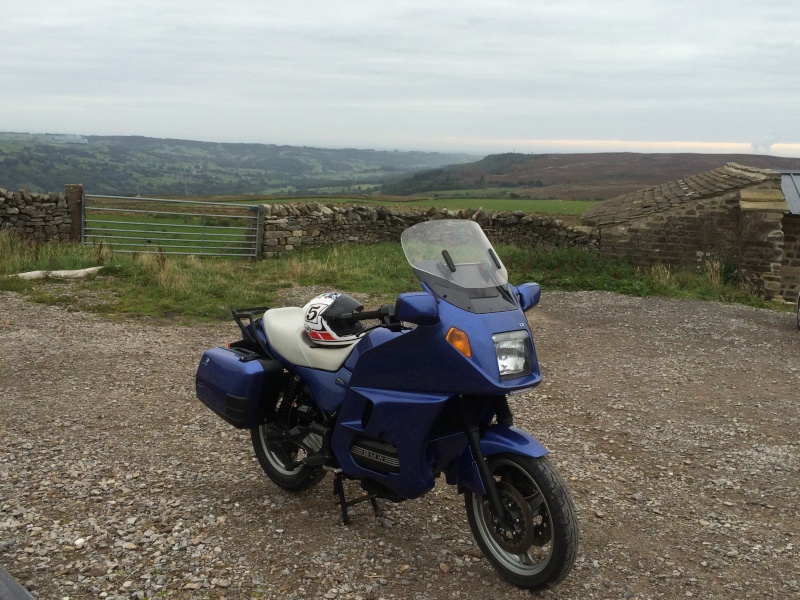

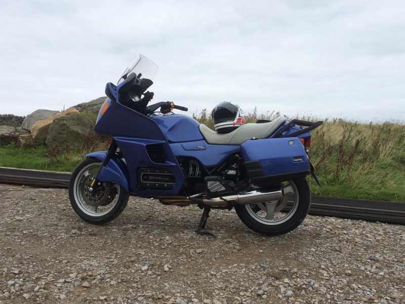

I was chatting to a very well known BMW engine specialist while we were having a poke around a K1100LT I'd bought earlier this year.
K series exhaust headers cracking? A possible prevention. Img_2110
K series exhaust headers cracking? A possible prevention. Img_2111
He looked where the headers joined the collector box and commented that they weren't cracked. He then went on to tell me that when the Police used to run the K11's, they would place a Jubilee or worm drive clip just ahead of the collector to move any resonance away from the welded joint, that's why the headers to crack.
I took his advice on board and did just that in the hope of keeping my exhaust in perfect working order; see below.
