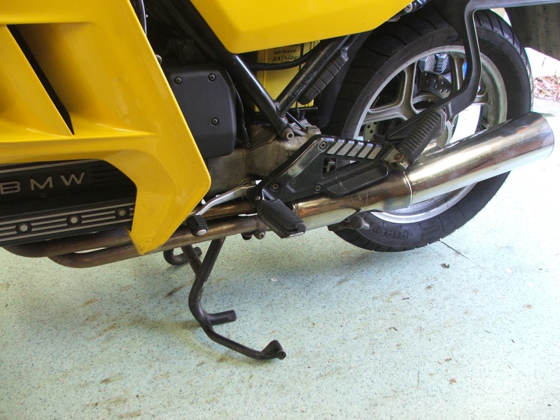

That 's the stainless studs done, next is center stand
Exhaust Nuts and Washers 20180510

14Back to top Go down   Exhaust Nuts and Washers Empty Re: Exhaust Nuts and Washers Fri May 04, 2018 7:04 pm
Looks like you've possibly got old gaskets stuck up in them there orifaces?
