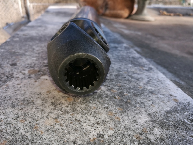

After 45 th kms I dissasembled final shaft to grease splines. Last time I did it at 135 th kms, now bike is on 180 th kms. At 135 I used ordinary cheap graphite grease and when opened the final drive grease looked rather fresh. Cleaned everything and put different barium complex grease for nautical use which is probably much more durable
Here are pictures of front and rear end of final drive after cleaning of old graphite grease
I have a question: Is there any possibility to mount back final shaft on some wrong way?Not to push enough?
Spline lube after 45 th km Final10
Spline lube after 45 th km Final110

nino wrote:I have a question: Is there any possibility to mount back final shaft on some wrong way?Not to push enough?
If you can't get the final drive unit on, then you need to push it more. Once it is on, all is well.
Your splines look good, better than mine did! But what do the splines on the final drive look like?

Everything is on, test ride done. No screaky sounds. I forgot to make a picture of final spline but it looked like new.
I was worried about type of grease aplied earlier, but graphite 5 USD for 1 kg did a job obviously. Grease didnt drie totaly
