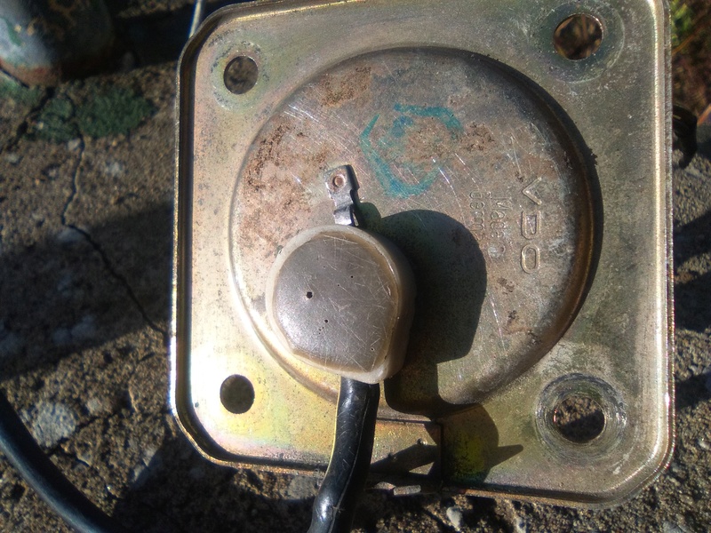

Hi, Fuel tank leaking fuel. Been parked for a couple of weeks.
   Around/ under the rear of the tank is wet with fuel [not pooling].
   Removed tank and fuel [6lt] no signs of corrosion inside or outside of the tank.
   Removed fuel sender unit to replace 'O' ring seal and noticed this on the electrical imput -
Fuel tank leaking Img_2010
Fuel tank leaking Img_2011
   Could fuel leak out of here, those pin holes and can it be fixed ?   Cheers Dale

DaleRT wrote:and noticed this on the electrical imput -
No, it's just a cover over the solder connections.

Put a new O-ring in it and see what happens, it will probably be OK as most O-rings have a 10 year life span and I will bet it hasn't had a new one since it left the factory.

Thanks for you’re responses.
   Will be doing a new ‘O’ ring. The old one is hard & cracks when it’s flexed.
      Thanks again   Dale

Replaced the rubber 'O' ring.
   The tank has been of the bike with fuel in it for this week and no leaking, all is dry.
