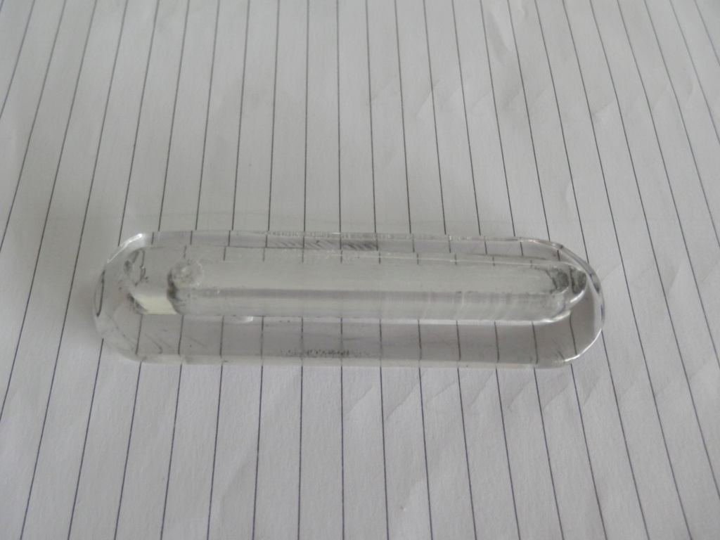

The sight glass on my K75's overflow tank is full of fatigue cracks. I ran an ad a few months ago chasing a replacement to no avail. A mate has got four of them in much the same condition. I was waiting for Motorworks to reopen. However I got a bit bored today and decided to have a crack at milling one out of a piece of round 25mm clear acrylic. I have access to a turret mill when the Trades Guild is open but they are currently closed for Christmas New Year.
So I reverted to my trusty drill press with it's cross slide vice. I have previously milled aluminium and wood on it. I used router bits in the drill press and finished it off with files and a bench grinder with buff wheels and polishing compound. I will give it a bit more buffing tomorrow and will eventually remove the tank and replace the old one with the new one. I'm pretty happy with how it came out, I did pick up a couple of tips from a couple of guild members. When milling acrylic there is no need for high speed and keep spraying it with WD 40. This will stop it sticking to the tool and the job and helps in keeping it's clarity. One of the guild guys did offer to make one on his small CNC machine but where's the fun in that.
Happy New Year regards Martin.
