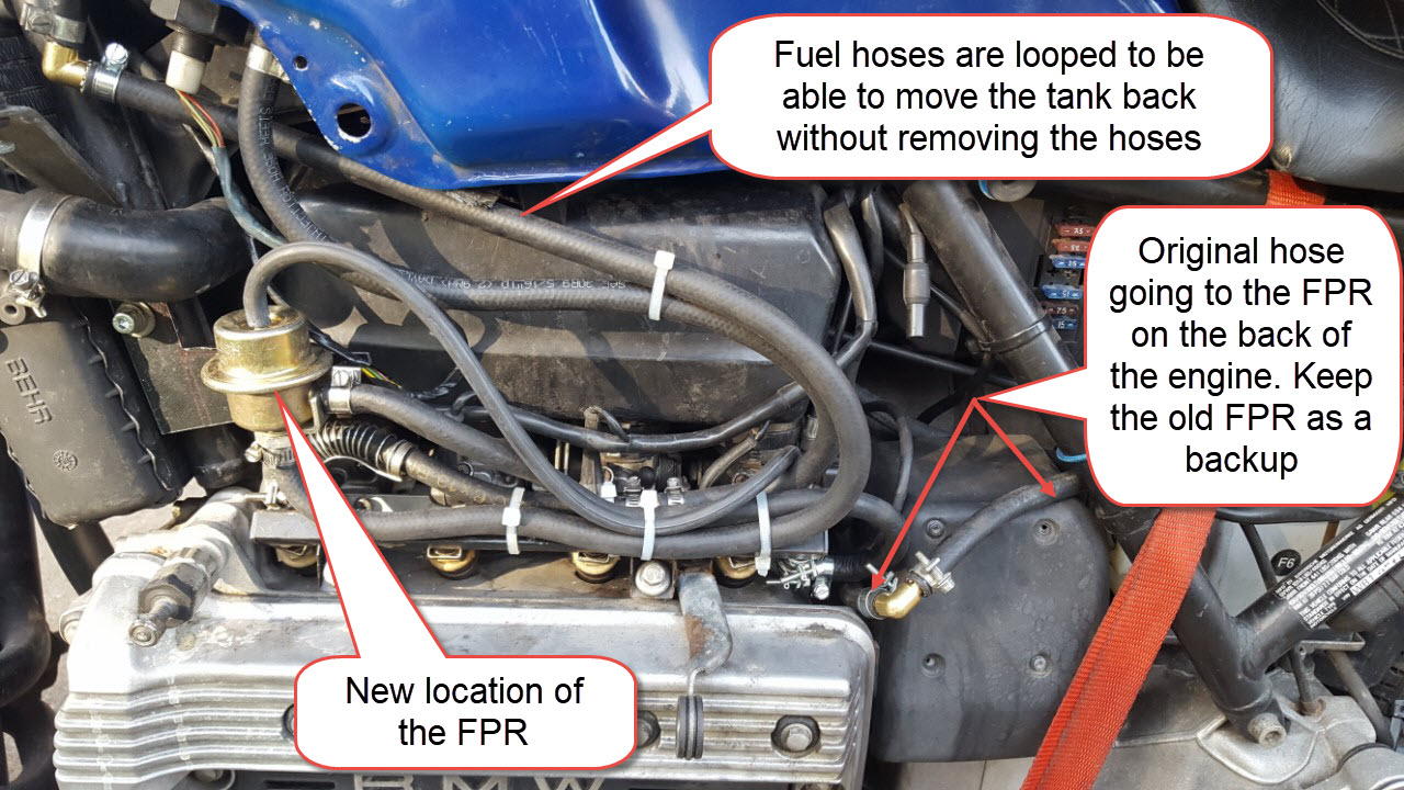

As I had to remove the sidecar, I decided to relocate the Fuel Pressure Regulator(FPR).
The 2 main problems with the FPR is its location..... Very difficult to access and certainly in the hottest place on the bike (Right between the air filter canister and the throttle body).
I installed it in front of the throttle body where it could be easier to access it in case of problems.
Note: I left the original one and just plugged the hoses. If needed, I could switch between the new one and the original one in no time.
My K is an RT and in order to remove the tank, at least the bottom fairing has to be removed to access the clamps on the tank's fuel hoses.
Last year, I extended the fuel hoses and electrical connections to be able to slide the tank back without having to disconnect it. This gives me access to the ignition computer as well as the electrical tray.
Here are pictures of the modification:
Relocating the Fuel Pressure Regulator 20190710
Relocating the Fuel Pressure Regulator 20190711

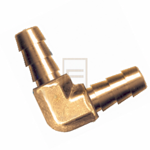

I used brass barber fittings to connect the hoses together and 90 degrees one for tight turns:
Relocating the Fuel Pressure Regulator Brass-10Relocating the Fuel Pressure Regulator Pgp_z110

I relocated FPR to the right side under the plastic side cover. Instead of original FPR I connected adjustable one from Ebay, but on cca 3 bars pressure. I think it runs better with slightly higher pressure.
I isolated fuel hoses with some electrical tubes which squeeze with heat gun. When you have long hoses behind hot radiator it deteriorate very fast, after few months. My opinion is that you need good thermal isolation of fuel hoses.
Consumption with 3,0 bars - about 5 liters on our old coastal road. I didnt check on highway.

I've seen a few of these relocation photos for the fuel pressure regulator and have wondered why folks keep using cylinder #4 for the vacuum hose.  In most cases using either cylinder #1 or #2 would make a cleaner install with less hose.
