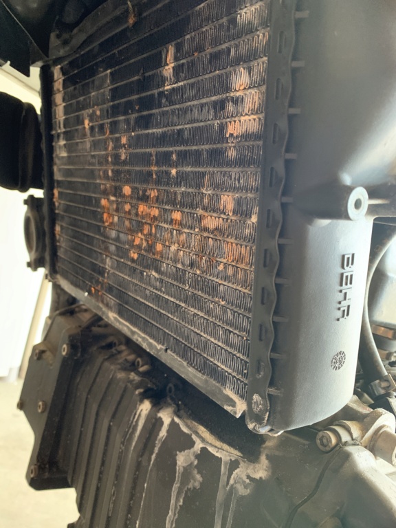

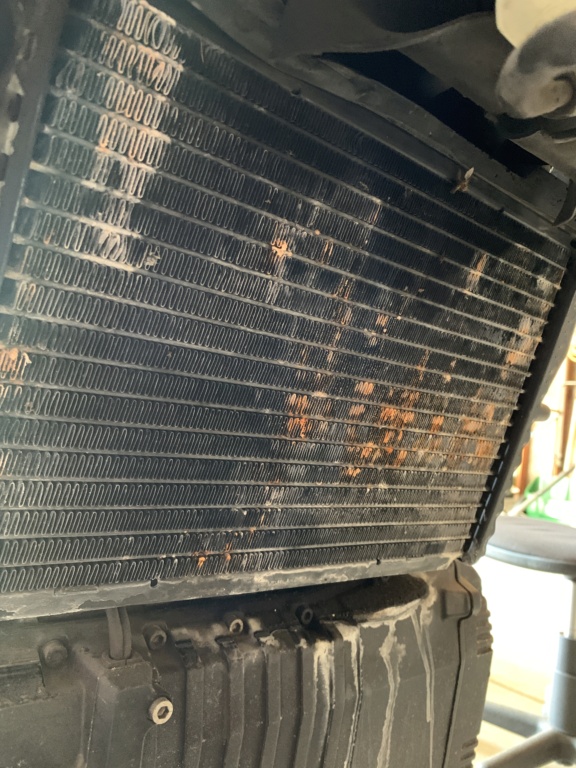

Hi everyone,
I recently purchased a 1987 K100RS with only 53K miles on it. The bike starts and runs fine, and it has not leaked fluids on the garage floor since I rode and parked it two weeks ago. Today, I started to do a full inspection to replaces fluids and any necessary part (e.g. bearing, seals, clutch, etc.).  However, the first thing I noticed it was the oxidation and water marks on the radiator. Is this normal on the K100s or could this be caused by a crack in the radiator or damaged hose or loose clamp.  Any advice on how to check or test it will be appreciated. TIA!
Radiator oxidation Img_0610
Radiator oxidation Img_0611

Considering the radiator and engine are made of aluminium I find the brown rust quite strange. Are you sure it hasn't just been splashed through a really muddy puddle or something?
When mine leaked (twice now..) I just had a wet patch in the fins and blue antifreeze crystals underneath the radiator. Nothing like this.

No its not normal. Im thinking wrong antifreeze or caustic cleaner has been used. Remove rad. Flush and test including hoses.Sould you find a load of crap flush full system to be safe.

I think that's possibly been splashed on from somewhere else. Check the grill on the lower front fairing - if that's rusty then it could be your discolouration source. Riding through a rusty puddle could also have done it. Also if the coolant has been in there for a long time I have also seen the inside of two radiators turn rust-coloured and the coolant came out looking lke a sluice from the Mississippi. It's obviously not a leak because otherwise as Snod says, you'd see a leak point.
5Back to top Go down   Radiator oxidation Empty Re: Radiator oxidation Thu Jun 10, 2021 1:05 pm
That looks like arid-land deposits. Did you get it from around San Bernardino, from around Palm Springs or east of Escondido? Smile
Disconnect the battery ground cable from the transmission after you've ridden it when you intend to put it away for days or weeks at a time. When the battery voltage drops, the starter relay contacts could fuse and you'll wonder why the starter won't shut off. If you habitually connect the battery to a battery tender that might be sufficient, if the battery is still in good condition. A battery isolator switch is a useful addition.

Thanks everyone for your comments and suggestions.  Today, I removed the radiator and used a compressor to blow out from the backside dirt and bugs. After that, I sprayed both sides with a garden hose on low pressure to flushed off the exterior.  It looks much better now (see pics below).  However, it seems that it's time to replace hoses and clamps for the engine intake L connection. Or, should I just clean them up and tie the clamps. What do you think?

Cooling system hoses usually survive years of abuse. I would, however, pull them off the thermostat housing and clean the ally spigot. It almost certainly looks worse than it really is, but as you're that far in anyway...
That radiator looks in really good condition, BTW.
8Back to top Go down   Radiator oxidation Empty Re: Radiator oxidation Tue Jun 15, 2021 8:21 am
+1 on Dai's advice. My experience is that the only way these hoses fail is through a crash.
Judging from the photos, I suspect hard water was used in the cooling system. Remove the hoses and all the cruddy cooling parts and do a vinegar soak for a couple hours followed by a good rinse.
Put everything back together and then do a complete cooling system flush with distilled water and vinegar to clean out the passages. You might have to do it a couple times to clean things out completely. Based on the mineral deposits in the photos this is critical to have good cooling.
Last, keep your fingers crossed that the water pump is still good.
