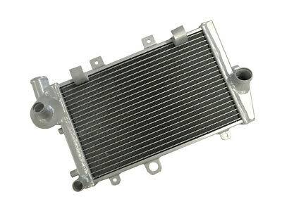

I would love to own a mill and a lathe and posses the skill to make nice parts, but alas I cant find anyone to swap my left nut with, and no matter how long I wait at the crossroads, the devil just dont show. So, will use these clip-ons and top triple clamp on the 1100 forks instead.
