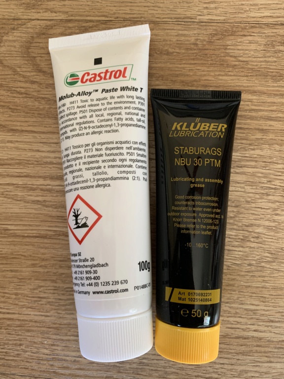

Thank you for confirming the condition and the suggestions.  Regarding lube, have you used the Castrol Molub-Alloy Paste White T as lube for the splines before or should I just stick with Staburags NBU 30?

The white paste has been superseded by the silver paste Molub-Alloy Paste TA. BMW part No 18 21 9 062 599.

MartinW wrote:The white paste has been superseded by the silver paste Molub-Alloy Paste TA.
MartinW,
Let me see I follow.  Are you saying that the Molub-Alloy Paste TA superset Molub-Alloy Paste T, which both are better than Staburags NBU 30?  If so, then I'm glad you pointed that out since I didn't what was the difference between the T vs the TA.  Thanks!
Final Drive Splines Img_0825
8Back to top Go down   Final Drive Splines Empty Re: Final Drive Splines Thu Jul 01, 2021 9:50 pm
Everyone seems to have their favourite. I think that as long as it has a high moly content 50%+ and you lube at least every rear tyre change you're fine. I've had my Brick for 20+ years and 178,000 K's and until the Castrol white T was superseded by the Silver TA I used it, I'm now using the silver TA.
