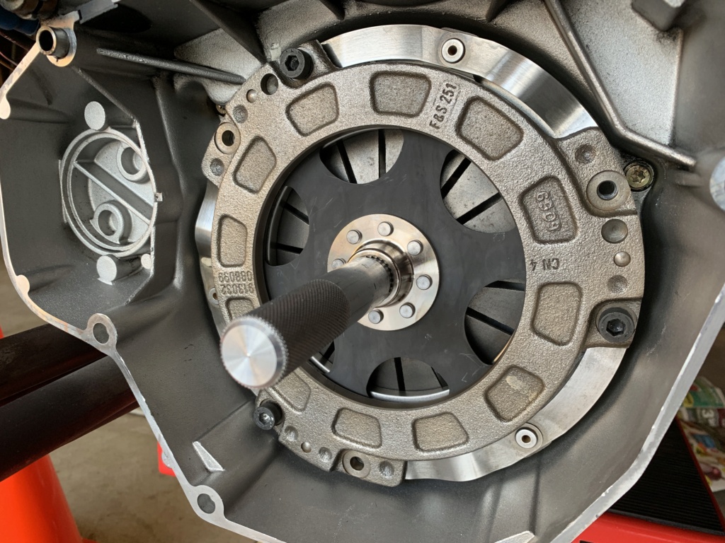

Can the clutch centering-alignment tool bind a little bit or does it have to rotate completely free as Chris Harris suggests?  Mine was rotating free until after I torqued the final two screws in the star sequence. Should I undo them and reposition it again?
https://youtu.be/RybnCX6PlIE?t=384
Clutch Centering Alignment Tool Img_0932

Has to turn free.
Unbolt, and try again.

Your photo seems to indicate that you fastened only three screws, bmwk100rs. This time, gradually and sequentially fasten all six screws while checking centering tool rotation.
Clutch Centering Alignment Tool Img_0910

Unbolted, readjusted, and re-torqued. It turns free now. Thank you, both!
Clutch Centering Alignment Tool Aligne10
