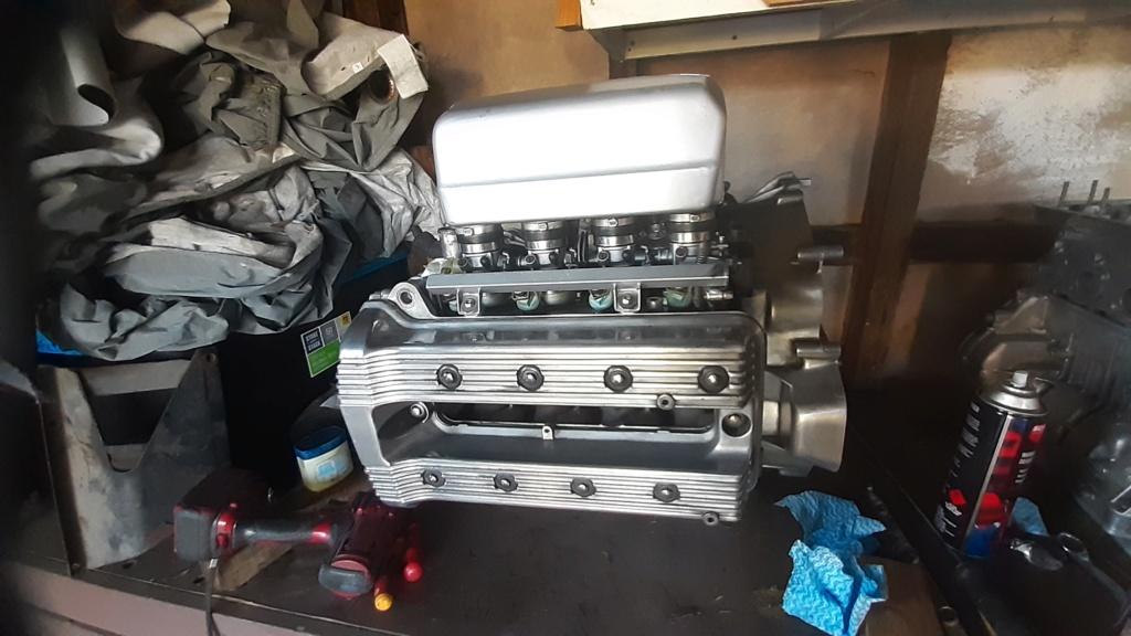

yes  removed the engine from the frame as i had just striped out the clutch centre ...again ..after procrastinating about lubing the clutch splines for so long ... and many kilometers , again through many rain event travels .
thought it was about time to do Gerty's output shaft in any case whilst  this deep into the gearbox - driveline disassembly .
I think that there is more compression when the motor is cold , or maybe just more reaction of acceleration of the crank when cold  rather than warm , so is much more noticeable and possibly less oil flung around the output gearset off the crank .
i think that its worthwhile doing now rather than later , as i think that the wear patterns setup by the excessive backlash could advance the compression wear of the barrel rubbers , then stressing out the rivets .
pitty it wasnt an late 88 bike as it would already have the 12 rivet assembly
its funny the rubbers i have seen and that i have replaced  dont follow any real service issues ...perhaps ...  maybe certain oils affect them ? or is it a production batch issue ?  along with worn backlash tensioner issues ?
in any case doing the backlash spring stuff would certainly give the opportunity to replace the inexpensive rubbers before more work needs to be done , besides replacing a 6 rivet with a 12 rivet output shaft second hand (even with low kilometers ) wont guarantee that you wont have to do the same all over again .
yes Alby's investigations were well noticed by me and other who were active in the forum back then .
ill post up some of the things i have found between a lower kilometer 6 rivet pre 85 shaft with good rubbers and no noticeable movement on the gear to damper ...and a 12 rivet shaft that came from our mate "Rene "...(who lives just round the corner these days )
in fact the 12 rivet shaft has noticeable wear on the output bearing .....which is not available anywhere at the moment , unless you can find a dealer that has one on hand ...
hope that helps some .
luckily i have noticed a lot of things , having been inside there more than twice
fortune has been on my side as i have a rebuilt motor with good 6 rivet output shaft and rubbers that i have been reassembling to go into Gerty for the time being ...
Service information bulletin 11 037 88 (2289) 20230322

Does the noise disappear with the clutch pulled in?
In the photo below you see a nut where the rivet was, just left of the Allen key.
Service information bulletin 11 037 88 (2289) Img_2095
A closer view.
Service information bulletin 11 037 88 (2289) Img_2096
So far I haven't convinced you to remove the alternator, so listen to this. Forum member Audibob removed the output shaft to fix a similar output shaft noise, we never did get to hear it though. He was understandably disappointed that he didn't find any obvious signs of wear. He put heaps of new parts in, put it all back together, and guess what, he still had the same problem. He read about other forum members who ended up in the same situation. He dived back in and reported back an improvement when he noticed the clutch balance marks were wrong by someone who previously went in there, and put it right. He still had some noise, he finally fixed it when he discovered that, guess what, the alternator wasn't installed properly.
Probably remove the crank cover first though, I spose.
I removed the alternator and the knocking sound is unchanged.
Dave
davemadsen
davemadsen
Fearing the worst, I looked at the cost of the Absorber Gear Wheel  11 21 1 461 499 and was dismayed to say the least. Then I checked what the new 12-rivet part cost and found the part number stays the same for all models through 1992. My understanding is the 12-rivet part was introduced in/after 1989; yet the part number is the same. Can you provide me with the 12-rivet part?
Dave
Dave
The six rivet unit is part 11211460903.
The twelve rivet is 11211461499.
Supersession date is 9/27/89.
