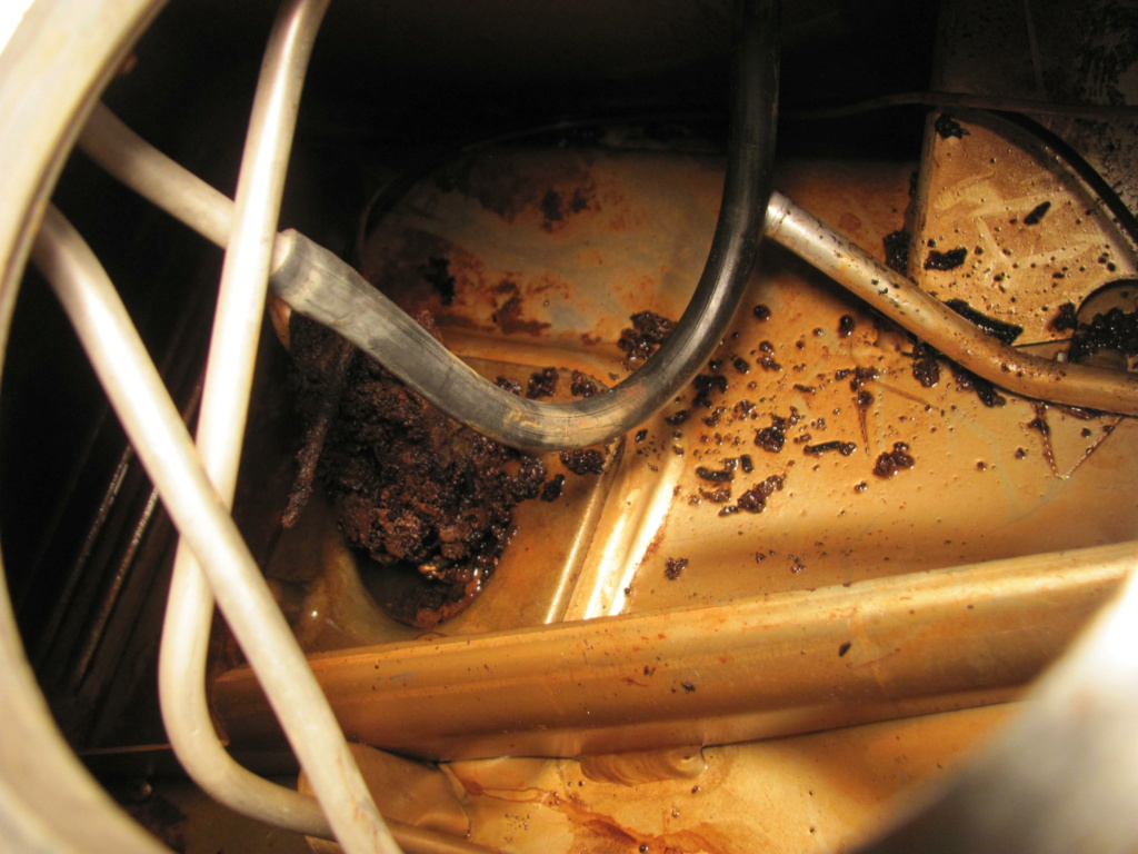

I replaced mine by getting a used one off Ebay for 20 bucks. My tank was totally trashed inside from sitting with gas in it for 15 years .I replaced everything inside the tank and down to the injectors.I just cleaned the injectors.I washed out the tank with detergent and water then used a 50/50 mix of muritic acid (concrete cleaner) and water  and the tank was like new after a final rinse with water.Fuel sender and tank Img_0911
Fuel sender and tank Img_2413
Fuel sender and tank Img_2414

Beautiful! A person could eat off that, if they could maneuver the cutlery in there; it's a shame to pour gasoline onto such a surface. Crying or Very sad

thanks for sharing your procedure and the final pic - lovely result Very Happy
