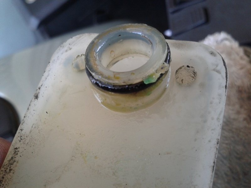

the base of the plastic likewise
![brake resevoir leak fix 2013-138](https://i.servimg.com/u/f57/16/13/61/46/2013-138.jpg)
