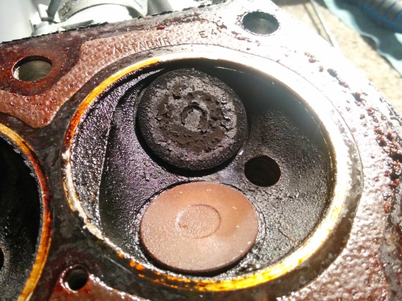

Got the cylinder head off last night to replace the cylinder head gasket and clean out the carbon when I noticed a heavy amount of white material on the exhaust valves.  It didn't come off with solvent like the carbon did elsewhere, and it was as hard as a ceramic.  As far as I know, the valve head should be smooth and reflective like stainless steel but it was on there so well that I just can't tell if it needs to be removed.
Should I grind this stuff off and recheck clearances?  Do I need new valves? I see that the valves (#11 34 1 460 201) are in the $135USD range (For one? For a set? It's unclear) so an aftermarket part would be desirable.  The problem is that the only info I can find in regards to the dimensions of the valve is a diameter of 30mm.
Thanks for the help!

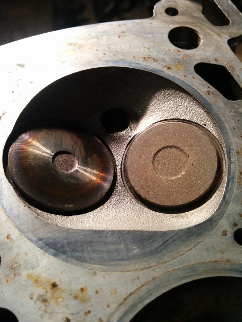

Here's a pic before cleaning.  Nasty!
'85 K100 2V Exhaust Valves Light Gray Img_2010
And here's a pic after.  You can see that the condition of the exhaust valve didn't change much, if at all:
'85 K100 2V Exhaust Valves Light Gray Img_2011

The are several BMW service manuals available in the download section. There are the Haynes & Clymer manuals, and the BMW Repair manual. They detail the specs on the valves.
I don't think the head of the valve that you can see is that important. If that's a burnt on coating, it may affect the thermal properties of the valve. The most important part is the face that mates with the valve seat. You may want to clean that up with some lapping compound since you've pulled the head.
A test in the BMW Repair Manual indicates that to check the valves for leaks, fill the inlet and exhaust ports with fuel. No fuel should leak past the valve heads. Also, you should inspect the seats. The manual indicates that the seats must not exhibit any chatter marks. The Haynes & Clymer manuals give good information on inspecting the valves.
The valves in the picture look normal. But, since you've got the head off, you should do a more thorough inspection.

A working bike or any engine will have that baked on coating on an exhaust valve.
The only reason it's not black is that the temperature is much higher on an exhaust valve.
I usually put the stem in a lathe and spin it up then use some 120 grade sandpaper to remove it then give it a bit of a polish with 240 grade paper.
Don't give it a good shine because it will only last about an hour at most.
diesputnikdie
diesputnikdie
Thanks for the tips.  I ordered the last set of seals from eBay and found the relevant section in the Clymer manual.
I took the Dremel with 120 grit sandpaper then 240 to the valve and things are looking nice and clean.  Not polished, but not faux-ceramic.  All of the seats look to be in fantastic condition and every valve passed the leak test mentioned above. I'll take a more thorough look with the manual this weekend.
