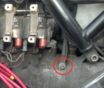

I doubt it's a timing issue. The Hall Effect Sensor is secured by two screws and I've never heard of an HES coming loose and altering the timing. When the notch on HES is aligned with the notch on the block where it mounts the timing is correct.
K100 power DSCF6344

Are the spark plug wires for Cylinder 1 and Cylinder 4 attached to the forward ignition coil and the wires for Cylinder 2 and Cylinder 3 attached to the rearward coil?
K100 power K100_i10
