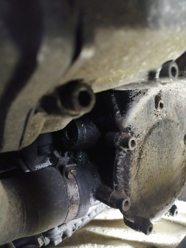

Finally warm enough to get out and investigate the contaminated moly on the final drive splines and found a smallish oil slick under the engine. I have a really mucky residue on the r/h (facing forward) upper quadrant of the oil/water pump. The oil filter cover is slick with fresh oil and clearly the source of the drip but probs not the leak.
I’ve scrubbed the sump, filter cover and water pump with degreaser and will dry that  off and spread some talc around. I’ve seen the posts about leaks around the l/h bottom quadrant but nothing for the opposite.
Views please on possible sources of the leak.
Is there a realistic track from the water pump down to the sump or have I got two issues (the oil filter cover bolts are tight but it will get the talc treatment too).
Last trip was a 200 miler and oil in the sight glass has gone fron 2/3 full to 1/3.
Prepping for a Feb trip so guidance appreciated as a big job may need me to change focus to the other bike. Cheers oil on r/h side of pump 212902

2Back to top Go down   oil on r/h side of pump Empty Re: oil on r/h side of pump Thu Dec 22, 2022 10:00 am
My memory's £0.02p says that the cover needs resealing.

Dai wrote:My memory's £0.02p says that the cover needs resealing.
Thanks Dai, I’d be a very happy bunny if thats all it is, but isn’t it just water in the outer half?
I have a pump on my spare engine and may refurb that while I’m at it.

4Back to top Go down   oil on r/h side of pump Empty Re: oil on r/h side of pump Thu Dec 22, 2022 3:11 pm
Yes and yes. Have to admit, this is likely to be my last Dragon. All the fun and adventure has gone out of it, mostly due to the Nanny State's H&S rules. The cost of getting across the Irish Sea doesn't help either. Conwy MCC can't have a bonfire because - heaven forbid! - someone might be under the influence of alcohol and within fifty feet of the fire. Campfires were banned years ago, again because of the same stupid H&S rules. In forty years I've done 34 of them; 34 in 38 if you take out the Covid years. I have a large collection of Dragon badges, empty whiskey bottles from the goodie bags that are still covered in mud and slate coasters from various years. Will I be sad to quit? Sort of, but not much given the above.

Ta. Does your first yes mean you’ve changed your diagnosis on the cover seal?
 I’ll get it off anyway, cos I have nowhere else to go with it and I’ve never inspected the impeller, shaft or seals.
On your second I agree about the ferry, would love to come to Ireland but its almost as silly money as the IOM, so I’m taking the Busa to France this Summer. Hopefully we’ll catch up in Feb.
All feeling a bit daunting atm as I probs have to get the swingarm off as well to understand what has contaminated the splines. This is the first time the K has felt like I have a mountain to climb since I brought it back to life, shame as its such a brilliant ride.

The one time I had oil round the engine like that turned out to be very little oil, quite a lot of coolant and even more cow droppings. Given how easy it is to remove the pumps, I'd think about replacing the gasket on the oil pump side.
